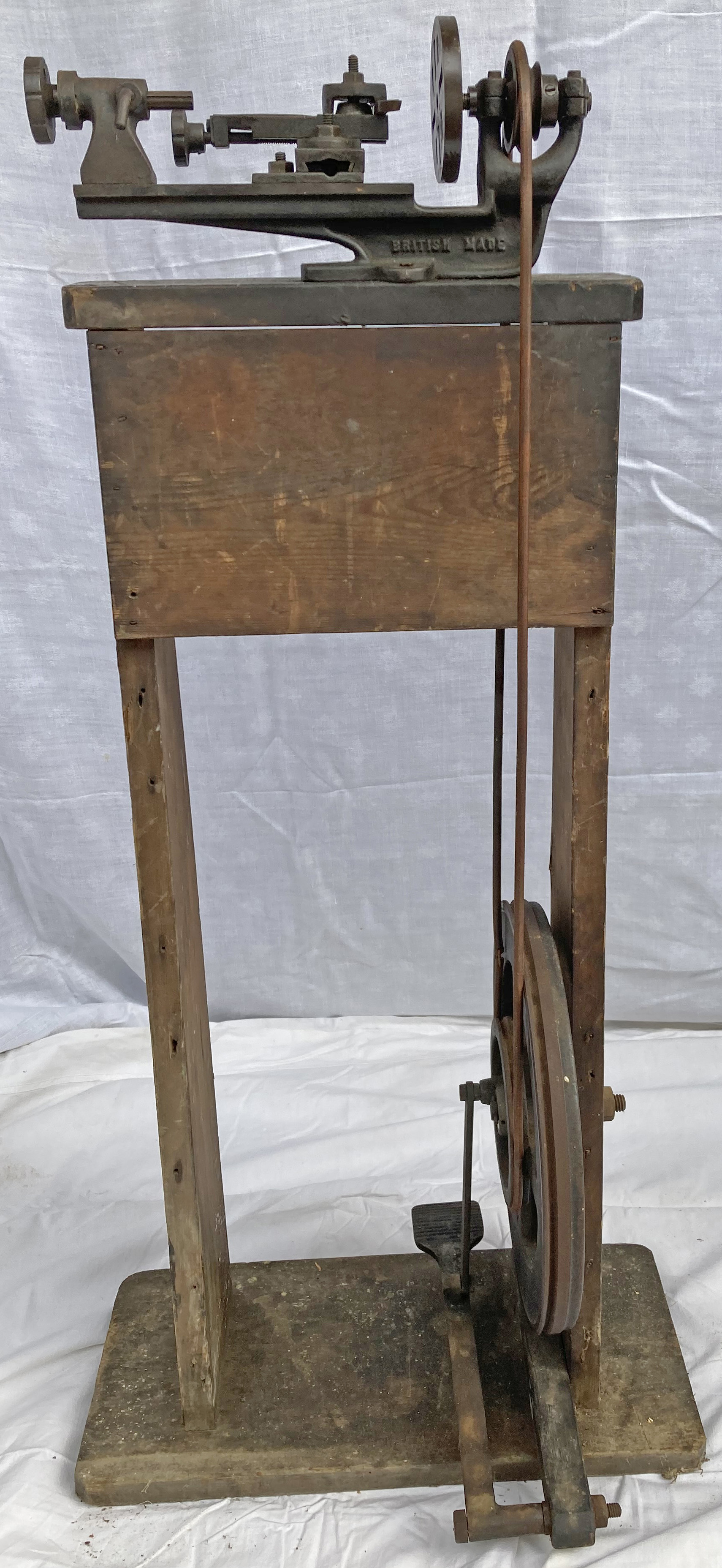

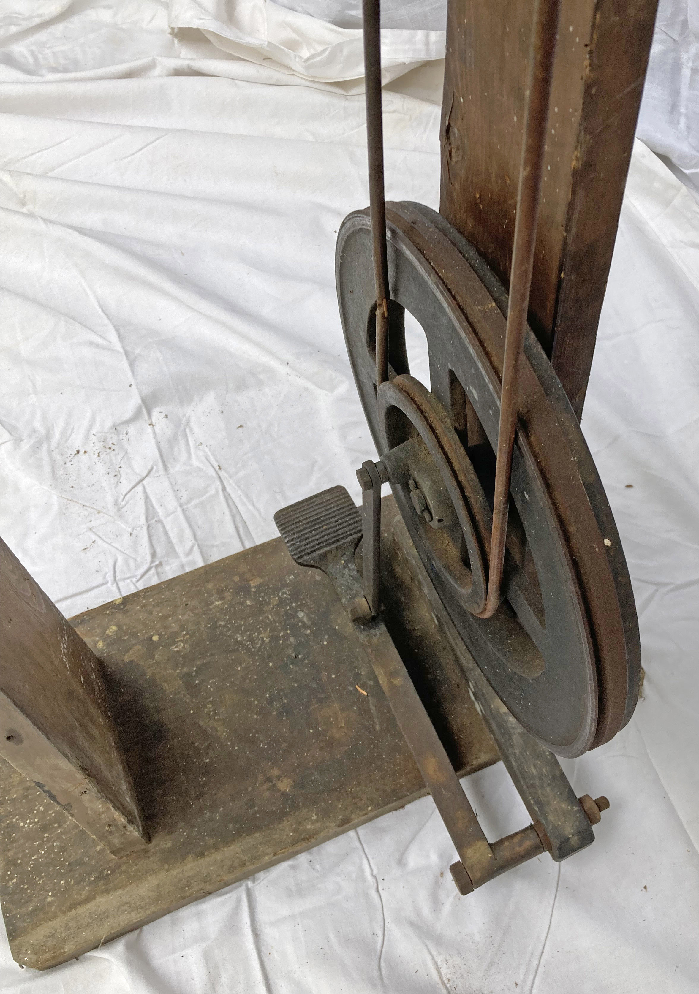

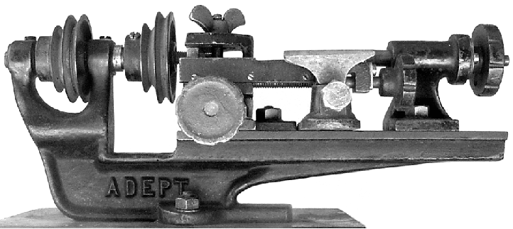

The ordinary "Adept" version of the lathe was fitted with a bolt-on compound slide rest located in a slot machined down the centre of the bed (the edges were left un-machined). The longitudinal cut was taken, as usual on this type of arrangement, by the top slide and its length was accordingly limited. This lathe also has the maker's hand-turning rest fitted to the right of the compound-slide assembly.
For several decades the writer was uncertain if this "most economical" set-up was ever marketed or was just a "serving suggestion" for home construction. He was wrong, it was a factory job and, 87 years after it was first offered, one came to light. Of course, it might have been sold as a kit of parts to assemble, or even as set of drawings - but the machine below and its stand do appear to mach the advertised machine perfectly.
Fitted to a neat - if perhaps unstable wooden stand - complete with a treadle flywheel assembly, it offered the home machinist a ready-to-run lathe at modest cost.
