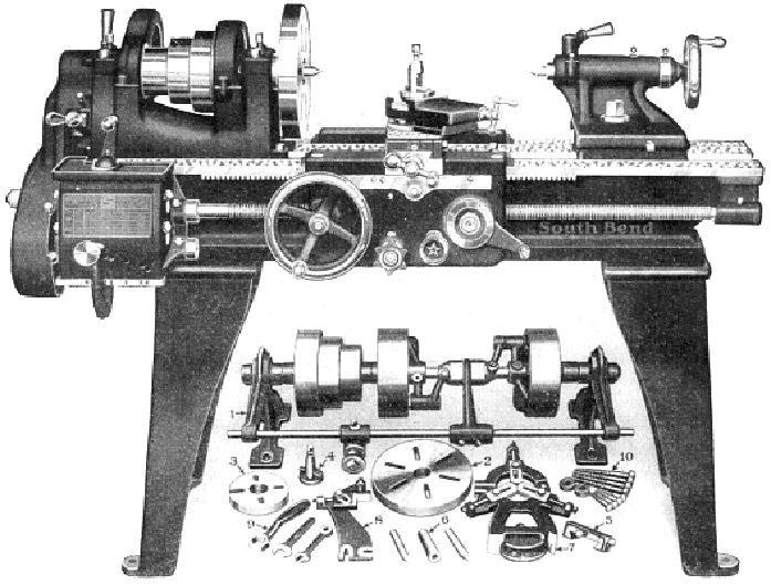

A wide range of industrial-quality, backgeared, screwcutting lathes was manufactured by South Bend and, so similar in appearance were the various sizes that, at a distance, it is sometimes very  difficult to tell exactly which is which. The lathe above is the 11" model with screwcutting gearbox and the model below the 18" version. The models in between were available with 13", 15" and 16" swings over the bed and with between-centres capacities ranging from 16 to 64 inches. Prices started at $585 for the short bed version and went up to $810 for the longest.  Missing from the South Bend lathe range until 1920 was the option of a screwcutting gearbox; rival makers had offered such a fitting for many years and South Bend's slowness to appreciate what a useful and profitable accessory it was is difficult to understand.
South Bend Large-Swing lathe. Jacking up the headstock and tailstock of a lathe is nothing new, as shown by this late 1920's machine. The lathe was constructed from standard parts, taken form the contemporary production series, but mounted on hollow, cast raising blocks which blended smoothly into the machine's original lines. The aim was to produce a lathe capable of not only  very-large diameter boring and facing, but regular work as well.  Three belt-drive models were available designated Models 1, 2 and 3 with swings of 32.5", 36.25" and 42.25" respectively. The same range of lathes was also available with a built-on countershaft unit with "Silent Chain" drive from an electric motor - when they became known as the 301, 302 and 303. Prices started at $488 for the smallest belt-drive model and rose to $1880 for the long-bed, chain-drive version.
