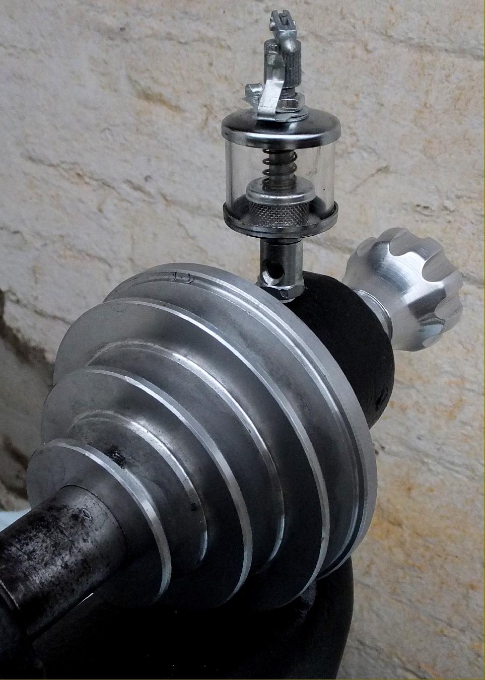

Equipped with all-lever feeds to the tiny longitudinal and vertical movements (4 inches and 3.25 inches respectively) and just 1.5 inches in traverse by a screw, this was a milling machine intended for the production of small components - probably incorporating the use of simple jigs and a long-suffering woman operator.
Photographed in its restored state with a V-pulley on the plain-bearing spindle, the miller would originally have been driven by a 3-step flat-belt cone pulley, almost certainly from a factory's overhead line shafting..
