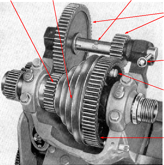

As its name implies, "backgear" is often a gear mounted at the back of the headstock (although in practice it is often located in other positions, such as an epicyclic inside the headstock pulley as also shown towards the bottom of this page) that allows the chuck to rotate slowly with greatly-increased turning power. For a novice the ability to run a workpiece slowly might seem unnecessary, but a large-diameter casting, fastened to the faceplate and run at 200 r.p.m. (around the bottom speed commonly found on a lathe without backgear) would have a linear speed at its outer edge beyond the turning capacity of a small lathe. By engaging backgear, and so reducing r.p.m. but increasing torque, even the largest faceplate-mounted jobs can be turned successfully. Screwcutting also requires slow speeds, typically between 25 and 50 r.p.m. - especially if the operator is a beginner, or the job tricky. A bottom speed in excess of those figures (as found on most Far Eastern and some European "Continental" machines) means that screwcutting - especially internally, into blind holes - is, in effect, impossible. These lathes are advertised as "screwcutting" but what that really means is just power sliding - a power feed along the bed. With these machines, even if you go to the trouble of making up a complex pulley system to reduce the spindle speed (like the early Atlas 9-inch), you will find the torque required when turning large diameters at slow speeds causes the belts to slip. The only solution is a gear-driven low speed - and so a properly-engineered small lathe, with a backgear fitted, not only becomes capable of cutting threads but can also tackle heavy-duty drilling, big-hole boring and large-diameter turning and facing; in other words, it becomes possible to use it to the very limits of its capacity and strength. To show how important backgear has always been considered, examine the specification of the many small English-made metal turning lathes made from the mid 19th century onwards: nearly every one was so equipped. For more on lathe parts and functions click here and for a further explanation of the desirable features required in a small lathe, click here.
Oil hole - there will be another in the pulley assembly
Small gear (SG) and 4-step V-pulley (V) are connected together permanently
![](img13.gif) |
Backgears (BG) mounted on an eccentric shaft.
Handle to rotate the eccentric mounting shaft and so engage the backgears
Pin (P) to connect and disconnect Bull Wheel and V-pulley. Instead of a pin, some lathes use a stud and nut arrangement - or even a quick-release fitting.
Bull Wheel (BW) - in this case with a ring of useful indexing holes, the locating plunger passing through the front face of the headstock casting
The backgear is a clever but essentially simple mechanism probably conceived around 1817 by Richard Roberts, an English engineer and prolific inventor. If you have to read the following several time to understand how it works, don't worry, everybody does…. In the picture above (a 1934 Atlas lathe) the 4-step V-pulley (V) has a small gear (SG) permanently attached to its smaller end. The entire length of V-pulley and gear are bushed - and able to rotate freely on the headstock spindle. The large "Bull Wheel" (BW) is keyed or held to the spindle with some sort of through-bolt or grub screw and always rotates with it. It can be connected to the V-pulley - and disconnected from it - by a pin (P) which is often spring-loaded, or by a nut and stud arrangement or some sort of quick-release fitting. In normal use the V-pulley is rotated by the drive belt and the spindle turned through the action of the pin driving the Bull Wheel and hence the spindle to which it is connected. To engage backgear the lathe is stopped, the pin (P) withdrawn (leaving the pulley and small gear free to rotate) and the Backgear (BG) rotated on its eccentric shaft to bring it into mesh with the other gears. On starting the lathe the action is now as follows: the pulley is rotated by the drive belt with the small gear (SG) on the V-pulley (V) driving the larger of the two rear-mounted backgears - which in turn causes the smaller gear at the other end of its shaft to rotate. This smaller gear drives the Bull Wheel (B) , and hence the spindle at a much lower speed (normally in the order of a 6 : 1 reduction) but with greatly increased torque. *If, instead of a pin, a bolt head is found, slacken this just sufficiently so that it can be pushed downwards to disengage the bolt that holds the bull-wheel and pulley together. If the nut is removed the pin may fall to the inside, sometimes requiring the whole headstock assembly to be dismantled in order to recover it. Examination of the headstock pulley and the backgear shaft may well reveal the presence of oil holes; these are important for, when working in backgear, considerable forces are being transmitted and the whole assembly requires frequent lubrication if it is to work reliably. If the pulley is allowed to seize on the headstock spindle considerable time - and possibly money - will have to be spent in order to free it off. Not all backgears engage like the one above: some, like the one on the 1906 Drummond illustrated below, just slide into position while others are held in a forked bracket with an operating lever and also slide sideways. Some are even built into the larger end of the headstock pulley and operate on a "epicyclic" principle, not unlike that of a Sturmey-Archer hub gear on a bicycle (an epicyclic arrangement is shown lower down the page) There is often a small mark on the pulley to show where the pin, that passes through the bull wheel, will engage (if this is missing, one could, with advantage, be made). The face of the pulley is often not a simple flat surface but hollowed out with a small drilled boss provided to carry the pin; if just pushed in at random and the lathe started, the pin will catch on the side of the boss and bend. If your backgear constantly jumps out of engagement there may be an adjustable friction screw with locknut, hidden away at the back of the casting, that bears against the shaft..
