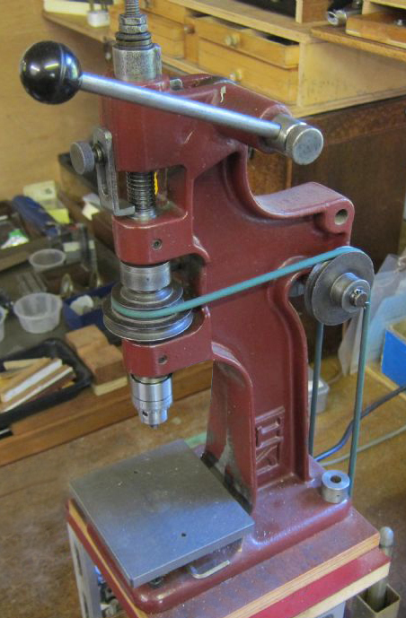

My thanks to Gavin Redshaw for his help in ongoing research into this matter.A robust little bench drill, the SHK or HKS, constructed, economically, from a particularly robust casting with  an integral foot. It was driven originally - like so many of its kind -  by a round "gut" rope passing upwards from a motor mounted behind the main column and passing over a pair of jockey pulleys. The 3-step pulley was fixed in position and the quill arranged to slide through it, a light coil spring wrapped around it providing some extra  "feel" to the action. The first example of the drill illustrated below has been converted to a more traditional system with its motor bolted to the back of the column - though there is no reason that the makers could not,, with a little imagination, have used something more like that on the rather lovely WA-CO
In place of a rack-and-pinion drive, the makers economised by arranging for the quill to be moved by a simple double-cam mechanism, one cam to lift, the other to lower.
Able to be raised on its round post (the length of which appears to be rather short) the table might have been made in two version, one as a semi-circle, the other square--though this type might well have been an owner's modification).
Why two holes are provided at the back of the column to carry the jockey pulley shaft is not known, though possibly an alternative drive system was offered - or the pattern maker decided it just looked better that way.

An SHK drill press with its original jockey-wheel guided drive system
