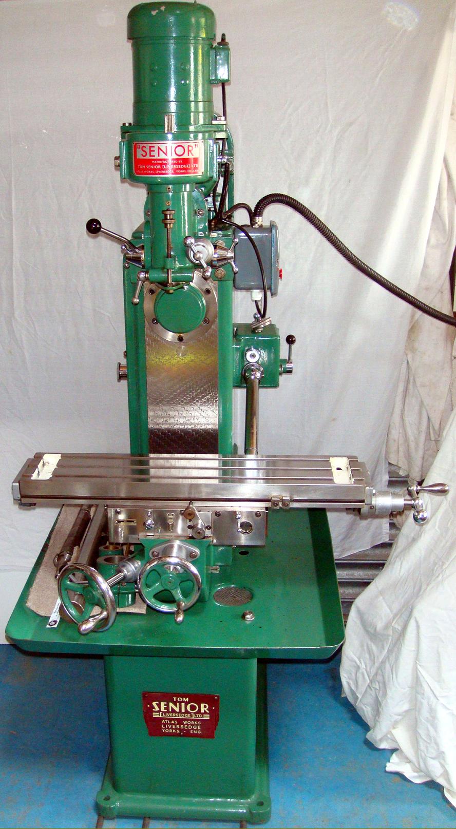

Tom Senior millers were always noted for their superb finish - the catalogue claiming, quite justifiably, that: "the paint work is superb and all machines are sent out with Exhibition Finish, being beautifully hand frosted". Although over the years a varity of machines were offered including the E Type, Junior Horizontal/Vertical, Light Vertical, VS and Major ELT the mainstay of the new range was the machine shown below, the M1. With both a 3-speed direct belt drive and a lathe-like "backgear" slow-speed drive built into the main column (the latter mechanism also incorporated a two-speed belt drive), this very robust little miller had twelve spindle speed of: 60, 86, 104, 136, 169, 267, 329, 537, 642, 845, 1050, and 1660 r.p.m. The 2-speed backgear assembly was an important addition for it did much to extend the scope of the miller's versatility - especially the ability to take very heavy cuts when used as a horizontal machine Instead of being flange mounted, and buried deep inside the oily recesses of the machine, the 1 h.p. 3-phase motor was fastened to a height-adjustable plate, conveniently mounted on top of the main column thus making motor replacement a simple matter - it being possible to fit almost any unit of the right power. The spindle ran in Timken taper roller bearings and was fitted first with a No. 3 Morse taper and then, following the general machine-tool trend, with the superior No. 30 International - a type that allowed heavier cuts to be taken yet with greater ease of removal and replacement.
With three T slots the 28" x 6.25" table, was powered through a 3-speed gearbox, driven from an extension to the rear of the main spindle via a Y-shaped arm that functioned both to tension the belt and keep the drive behind the main column where it could be safely contained inside the large, cast-aluminium rear cover. Whilst early table drives had a simple, exposed drop-in worm and wheel arrangement, later models were fitted with a more durable and robust oil-bath gearbox. 36 rates of automatically-disengaged feed were available (3 per spindle speed) from 0.25" to 28" (6 mm to 711 mm) per minute. The maximum longitudinal travel was 15.5", the cross 5.5" and vertical 14". Although the hand feed was normally by screw, some versions were made with a rack-and-pinion drive to make them more suitable for certain types of production work. The suds pump was driven by a plastic belt from a groove formed on the end of the lower main drive pulley. The machine stood 63" high, was 41" front to back, 38" wide and weighed a little over 7.5 cwt (372 Kg).

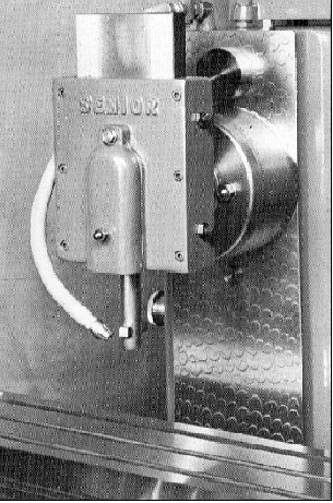

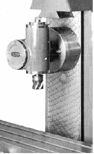

When fitted with the optional vertical head - especially the superb swivelling S-Type with fine and quick-action quill feeds - these machine makes an excellent all-round workshop miller and good examples are greatly sort-after type
