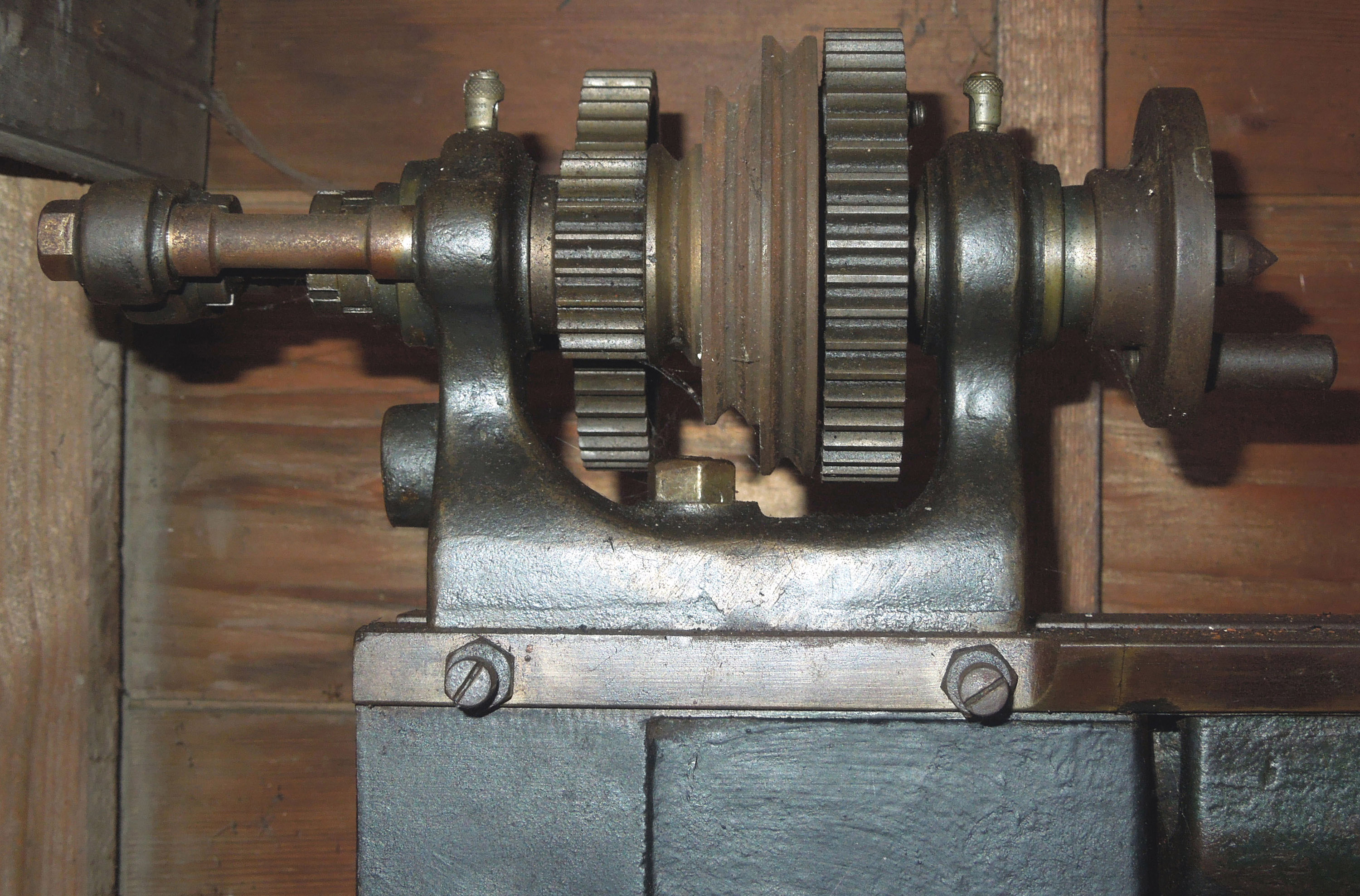

Lathes from Arthur Frith were of distinctly old-fashioned appearance, even for the early 1930s. The first machine produced is believed to have been a 3.5" centre height by 15.5" or optionally 24" between centres machine that was born into a competitive and hard-up world and, is it suspected, very few were manufactured. Described as the "Yankee" in some catalogues, the most common specification was a  9/16"-bore, No. 1 Morse taper headstock spindle that ran in plain bronze bearing. While the backgeared headstock appears to have been heavily built and capable of handling proper jobs, the flat-topped, V-edged bed, with its strangely-positioned feet, was noticeably shallow in depth. Unusually for a lathe of this size the tumble reverse was contained on the inside of the casting, where it was better supported and protected. A large set of 16 DP changewheels was provided as standard: 20t, 25t, 30t, 35t, 40t x 2, 45t, 50t, 55t, 60t, 65t, 70t, 75t, 80t, 85t, 90t, 95t, 100t, 105t, 110t, 105t and 120t. They drove to a 3/4" diameter leadscrew of determinedly Victorian specification with pitch of 4 t.p.i. and a square section thread.

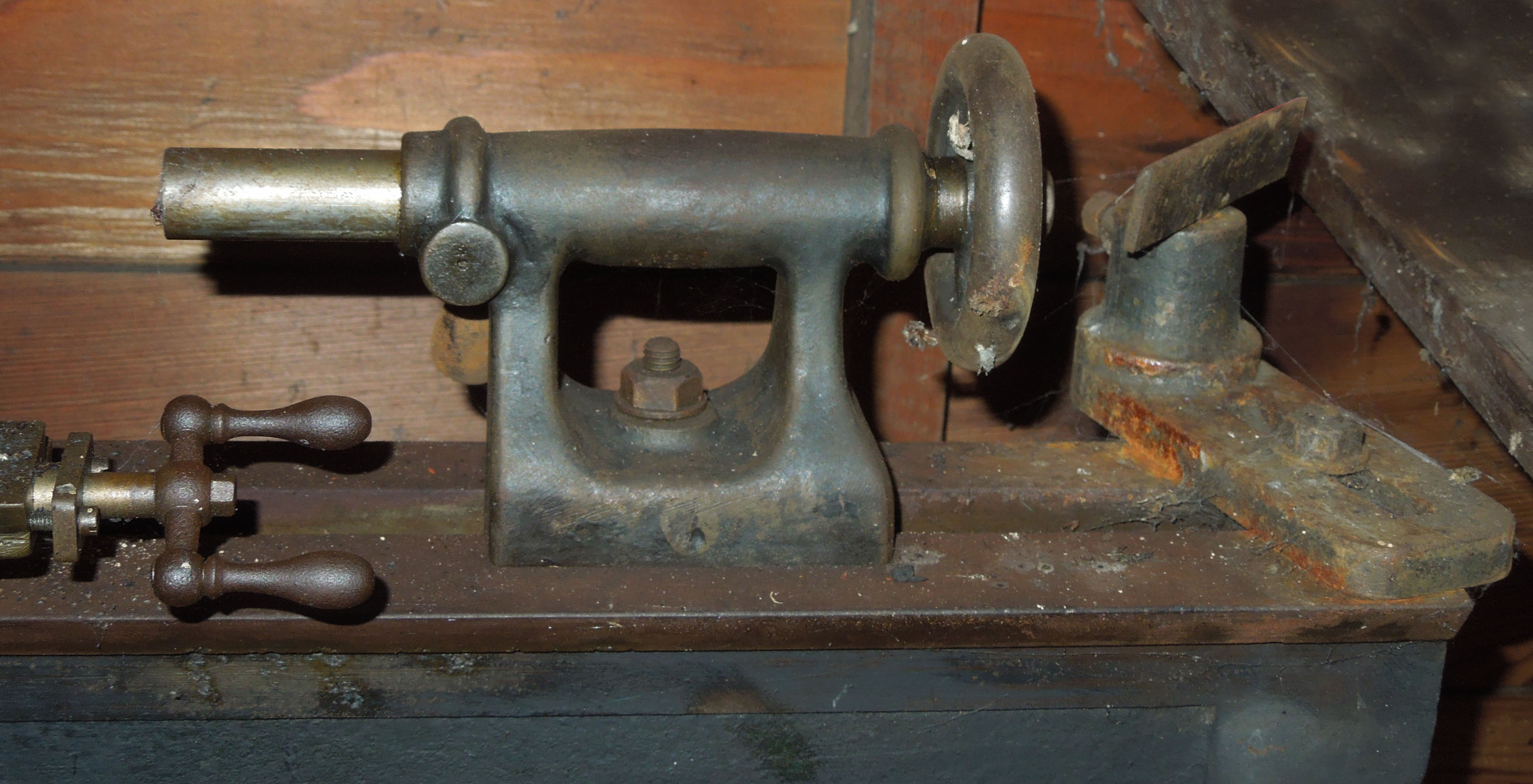

With a square-thread spindle that ran clear though the handwheel, and locked with a proper compression fitting, the tailstock was more up to date and of a design seen on lathes made into the 1970s.

A 3.5-inch centre height backgeared but plain-turning Firth lathe. It appears that the saddle and cross slide might be in bronze…..

Particularly robust backgears
