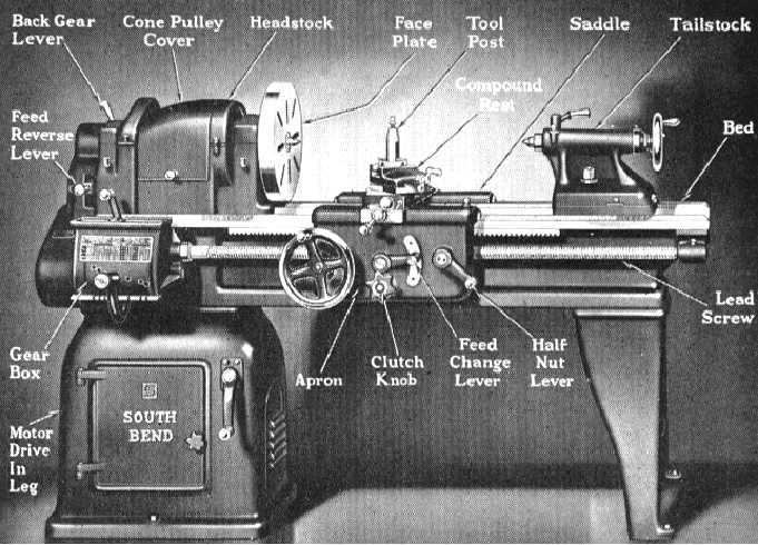

BED
The bed of the lathe provides the foundation for the whole machine and holds the headstock, tailstock and carriage in alignment. The surfaces of the bed that are finely machined - and upon which the carriage and tailstock slide - are known as "ways".

SADDLE
The casting that fits onto the top of the bed and slides along it is known, almost universally, as the "Saddle" - a self-explanatory and very suitable term.
APRON
The vertical, often flat and rectangular "plate" fastened to the front of the "Saddle" and hanging down in front of itm is known as the "Apron" and carries a selection of gears and controls that allow the carriage to be driven (by hand or power) up and down the bed. The mechanism inside can also engage the screwcutting feed and various powered tool feeds, should they be fitted. The leadscrew, and sometimes a power shaft as well, are often arranged to pass through the apron and provide it with a drive for the various functions. The sophistication of the apron-mounted controls, and their ease of use, is a reliable indicator of the quality of a lathe. Virtually all screw-cutting lathes have what is commonly-called a "half-nut" lever that closes down one and sometimes two halves of a split nut to grasp the leadscrew and provide a drive for screwcutting.
Apron design can be roughly divided into "single-wall" and "double-wall" types. The "single-wall" apron has just one thickness of metal and, protruding from it (and unsupported on their outer ends) are studs that carry gears. The "double-wall" apron is a much more robust structure, rather like a narrow, open-topped box with the gear-carrying studs fitted between the two walls - and hence rigidly supported at both ends. This type of construction produces a very stiff structure - and one that is far less likely to deflect under heavy-duty work; another advantage is that the closed base of the "box" can be used to house an oil reservoir the lubricant ion which is either splashed around or, preferably, pumped to supply the spindles, gears and even, on some lathes, the sliding surfaces of the bed and cross slide as well.
COMPOUND SLIDE REST consisting of the CROSS SLIDE and TOP SLIDE

CARRIAGE
The whole assembly of  Saddle, Apron, Top and Cross Slide is known as the "Carriage". Some American publications (even makers' handbooks) have been known to casually refer to this as the "Saddle" - but this incorrect.
HEADSTOCK.
The lathe Headstock used, at one time, to be called the "Fixed Headstock" or "Fixed Head", and the rotating shaft within it the "Mandrel". Today the mandrel is usually called the "Spindle", but this can cause confusion with the tailstock, where the sliding bar is known variously as the "ram", "barrel" - and "spindle".

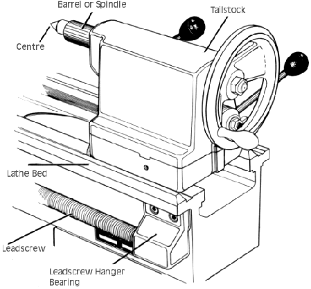

LEADSCREW
Originally termed a "master thread", or described as the "leading screw", but now always referred to as the "leadscrew", this is a long threaded rod normally found running along the front of the bed or, on some early examples running between the bed ways down the bed's centre line. By using a train of gears to connect the lathe spindle to the leadscrew  - and the leadscrew to the lathe carriage - the latter, together with its cutting tool, could be forced to move a set distance for every revolution of the spindle.
TAILSTOCK
The Tailstock was once known in England as the "loose stock",  " Ppoppet head" or "loose head" - the latter old-fashioned term being used by Harrison and other English firms in some of their advertising literature until the early 1970s. The unit is arranged to slide along the bed and can be locked to it at any convenient point; the upper portion of the unit is fitted with what is variously called a "barrel", "spindle" "ram" or "shoot" that can be moved in and out of the main casting by hand, lever or screw feed and carries a "Dead Centre" that supports the other end of work held (by various means) in the headstock.
Special centres, which rotate with the work, can be used in the tailstock ; these are known as "Rotating Centres" and should not be referred to as "live centres" - that term being reserved for the centre carried in the headstock spindle.
Long ago centres were referred to by turners as "Poppets" - presumably from "pop it in" - and they carried their own with them, secured in cotton waste and jealously guarded in the top pocket of their overalls.
