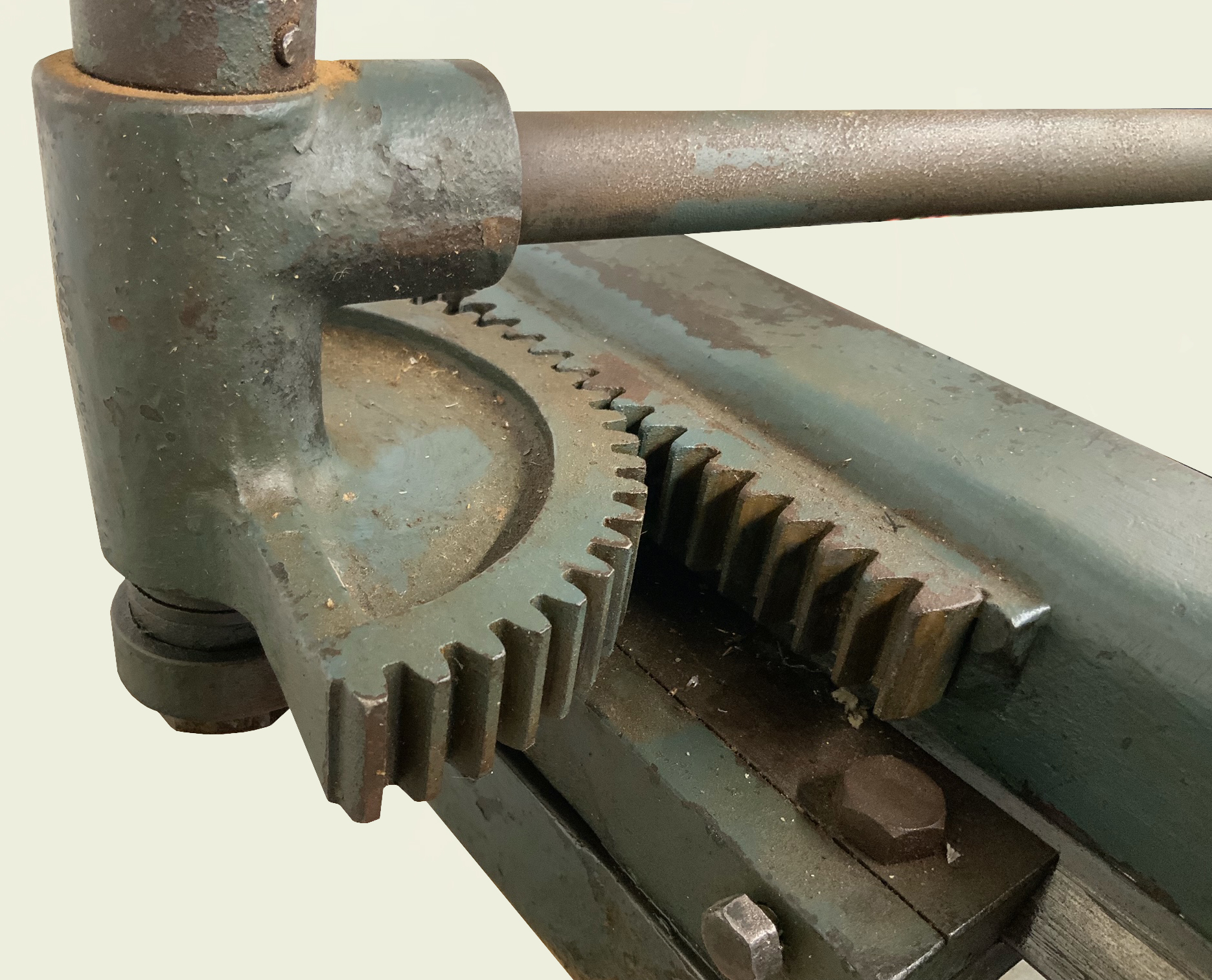

Advertised from the late 1800s onwards as being by Pittler (though not marked as such) this 6-inch stroke shaper was sold by the UK's Pittler agent, George Adams of 144 High Holborn, London.
Hand-powered, the Pittler used a simple rack-and-pinion drive to move the ram, exactly like the very much later machine from Perfecto, a model sold until the early 1980s.
With a ram stroke of a little over 6.6 inches and a tool-slide feed of 2 inches, the shaper was able to machine a surface 6" x 8". Before the introduction of the planer and shaper, obtaining a flat surface involved much hard work with a chisel and file. Hence, clearly aimed at the amateur and small professional workshop, the "Pittler" would, therefore, in contemporary times, have saved much tedious (and less accurate) handwork. Advertised at £12 complete with power cross feed by the usual indexing ratchet mechanism, a small saving could presumably have been had by omitting this very useful feature. As the machine illustrated in the sales flyer from 1900 reproduced below has several detail differences to those in the photographs, the machine must have been sold for many years. These differences point to either a steady, detailed development of its construction - including the fitting of a micrometer dial on the toolbox down-feed screw - or Mr George Adams arranging its manufacture by another company.
