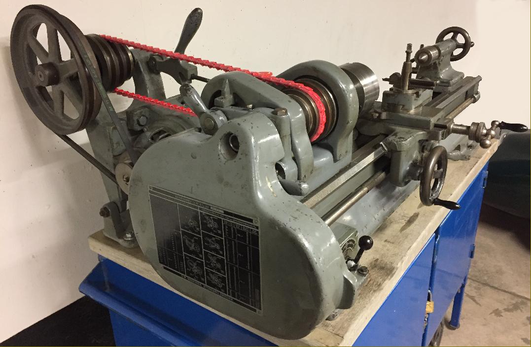

A Storebro fitted with a power-feed apron and screwcutting by changewheels - the equivalent of a South Bend Model B
Note, on this Storebro South Bend copy, the use on the apron of lever engagement for the
power sliding and surfacing feeds instead of the usual screw-in-and-out star wheel
The top-mounted oilers fed onto a felt pad set half-way up the bearing
Storebro Model C- immediately identifiable by the switch built into the headstock-end bed foot.
The aluminium headstock pulley suggests that this lathe has been converted to V belt drive.
The tailstock barrel locking clamp is arranged to pass horizontally below the shaft instead of vertically at the rear.
