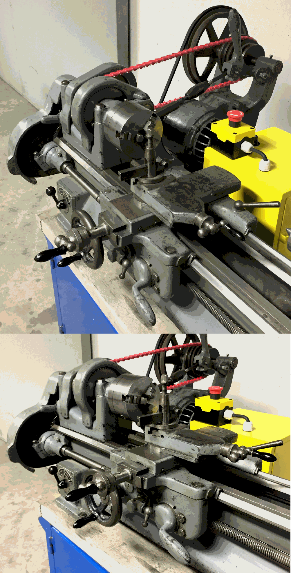

Like the Swedish Blonqvist, the Storebro South Bend clone, had a bed with integral feet. The rest of the lathe, apart from the cast-in mounting for the electrical switch, was pure South Bend. It is not known if a range of models with power cross feed and screwcutting gearboxes was manufactured and if any reader an provide additional data on this point, or owns a Storebro South Bend clone  the writer would be pleased to hear from them.
A Swedish Storebro - immediately identifiable by the switch built into the headstock-end bed foot.
The aluminium headstock pulley suggests that this lathe has been converted to V belt drive.
The tailstock barrel locking clamp is arranged to pass horizontally below the shaft instead of vertically at the rear.
