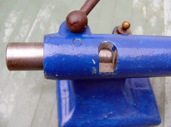

Although a choice of different designs of countershaft was offered, including bench and ceiling types (and perhaps an unusual vari-speed type), the lathe could also be supplied on a neat, underdrive stand (of which, unfortunately, no picture survives) almost certainly very similar to that offered for the Boley & Leinen equivalent. If mounted in this way, a different headstock casting was used with a hinged top cover and both front and back faces spaced out to accommodate the drive belt. Although spindle speeds were advertised as running from 200 to 2000 r.p.m., the actual range would, of course, have very much depended upon the type of drive system chosen by the customer and the r.p.m. of the motor Unaccountably, apart from the window in the casting to show the division scale, the tailstock differed from the traditional pattern fitted to this type of precision lathe. Instead of the spindle's full length passing through the casting, and emerging from both ends (to give maximum possible support no matter in what position), on the Excel a conventional centre-lathe design was used, this having reduced support as the spindle was extended. The No. 2 Morse taper centre was self-ejecting and the barrel, locked by a proper two-part compression clamp, had a just-adequate 2˝-inches of travel. Although it's not known precisely what accessories were available for the Excel, for the very similar Leinen and G.Boley versions, a comprehensive range of extras was listed including bed-mounted capstan units for production work; chase screwcutting equipment; conventional screwcutting using changewheel together with power feed to the top slide; steadies; various kinds of toolpost; several different designs of tailstock and micrometer stops, etc.

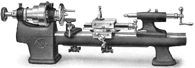

For comparison - the Boley No. 3 & No. 4 (90 & 120 mm centre heights)

Tailstock cut-out to expose the ruler graduations on the barrel
