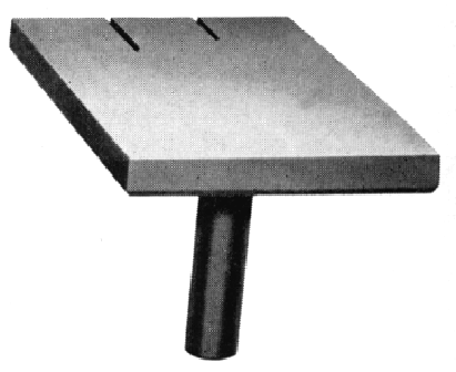

An L-shaped rest, to socket into the casting on the left, and designed to enable the worker to "get into awkward corners."

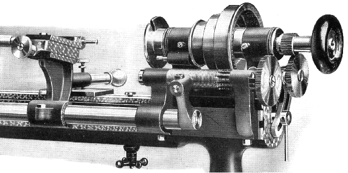

The Cataract lathe could, like most quality lathes of its type, be provided with either changewheel-driven "top-slide" or traditional "chase" screwcutting - the latter system was devised by Joseph Nason of New York who obtained US Patent No. 10,383 on January 3rd, 1854 for an "arrangement for cutting screws in lathes." In the Cataract interpretation a T slot, which ran down the back face of the specially-cast bed, held supports carrying a sliding transmission bar and, above it, a "master thread". At the headstock end of the assembly additional gearing was provided to extend the threading range (by a multiple of six) for each Thread Master used. A follower (with an interchangeable tip carrying a few threads of the same pitch) pressed into the Master Thread and transmitted its motion, via a sliding bar, to a threading tool held against the workpiece in an adjustable toolholder. Whilst this system produced absolutely-accurate threads, and was especially suited to delicate operations on the thin-wall tubes used to construct such items as microscopes and the bodies of camera lenses, the length of thread that could be cut, and the number of threads per inch or mm, depended upon the availability of the appropriate Thread Master. A useful touch was that Cataract Master Threads (like those from Pratt & Whitney) could be supplied complete with a hob at one end for chasing nuts to suit the thread being generated in the lathe. An alternative form of screwcutting, and the only type available on lathes with a "plain" bed, was provided with a set of changewheels and a splined, universally-joined shaft which drove the top slide; the arrangement is illustrated below..

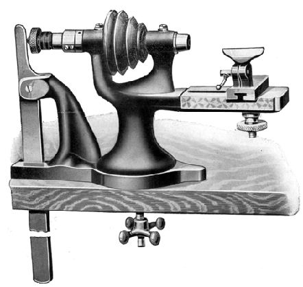

Cataract Universal Three-slide Grinder Although casual use of a lathe as a grinding machine can have grave consequences for its longevity, if careful precautions are taken to keep the abrasive dust away from slideways, screws and bearings, no harm need be done. In the days when one lathe might be called upon to perform many functions, all makers of precision bench lathes, including Cataract, offered their customers a comprehensive range of grinding attachments. Shown above is a unit designed to be used for both internal and external grinding, attached to the bed in the same manner as the compound slide rest. The middle slide was not fitted with a feed screw, but was provided with an adjustable stop so that the upper section of the unit could be instantly withdrawn from the work - and reset immediately in the same position without disturbing the setting of the feed dial. The hardened, ground and lapped spindle, 10" long, 0.490" in diameter with a Hardinge No. 3 taper in each end, had a maximum travel of 2.625" and could be run at 10,000 rpm. The swivel base was 4.5" in diameter and the upper part of the assembly was securely held to the lower by four bolts. In use, the longitudinal feed of the spindle was controlled by hand - the round black knob on the end, fitted with hardened and ground bearings, providing a thumb and finger grip; all the grinding attachments listed by the Cataract operated the sliding feed in this simple but effective way. Whilst comprehensive in range, and type, Cataract accessories were not greatly different from those of their competitors, with the possible exception of the beautiful "Universal Three-slide Grinder", shown below.

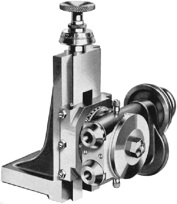

Lever-action Tailstock with Cross Feed This tailstock was, for its time, substantially built, and designed to assist in boring, chambering and facing operations whilst being also perfectly useable as a standard unit. The cross-slide movement was 2.25" and the micrometer dial was of the zeroing type. The barrel, 10.375" long and 0.787" in diameter, had a rack and pinion drive with a feed-length of 2.75". An adjustable stop, with a hardened pin, was fitted between the barrel and its steady rod.

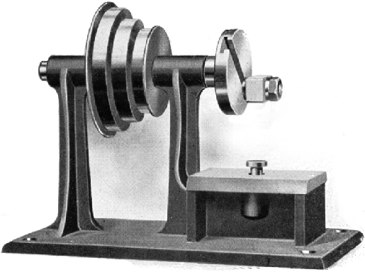

A powered filing attachment - driven from the lathe spindle nose by an adjustable eccentric. This useful accessory was intended for the finest of work by the most skilled of workers.
Filing Attachment Stand Where the filing attachment was in regular use, or the lathe busy, this separate stand and drive system was available which made the unit self-contained.

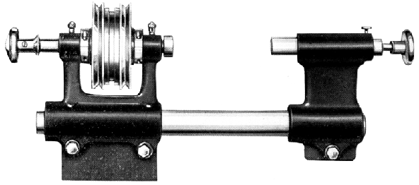

Horizontal Tapping Machine. The unit was intended for the rapid tapping of small parts; both headstock and tailstock were sized to accept No. 1 cataract draw-in collets - which had a maximum capacity of 0.25" - and the workpiece could be held in either. The headstock carried two "round-rope" pulleys, each intended to be driven in opposite directions and engaged by a simple cone clutch fitted between them. By this means the tap could be run into the job, then immediate reversed out by engaging the other drive - although the lever system which accomplished this task was not illustrated in the maker's catalog.

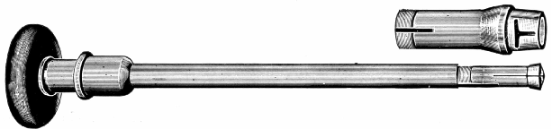

Standard draw-in collet draw tube shown with a special collet carry a replica of the standard Cataract spindle-nose fitting.
