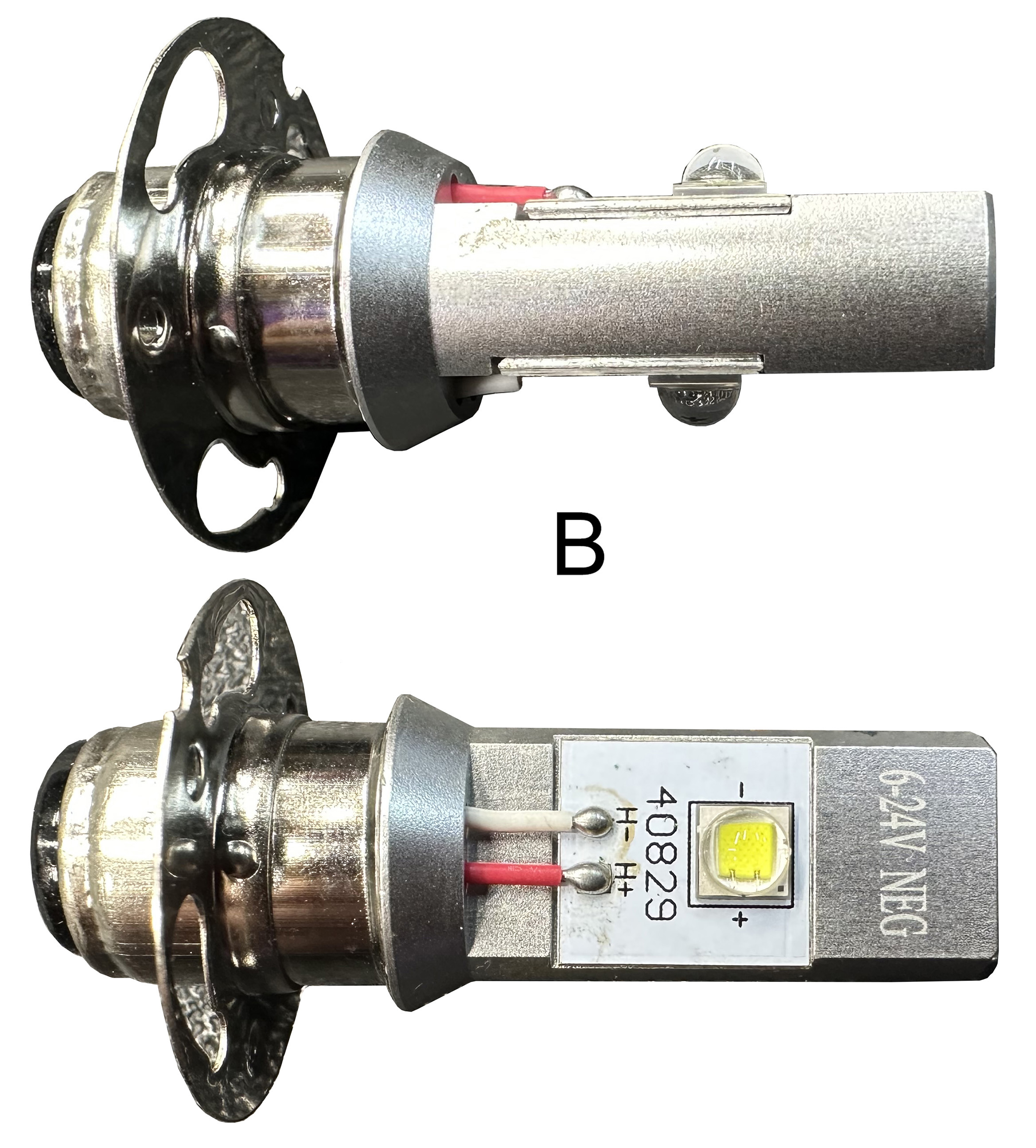

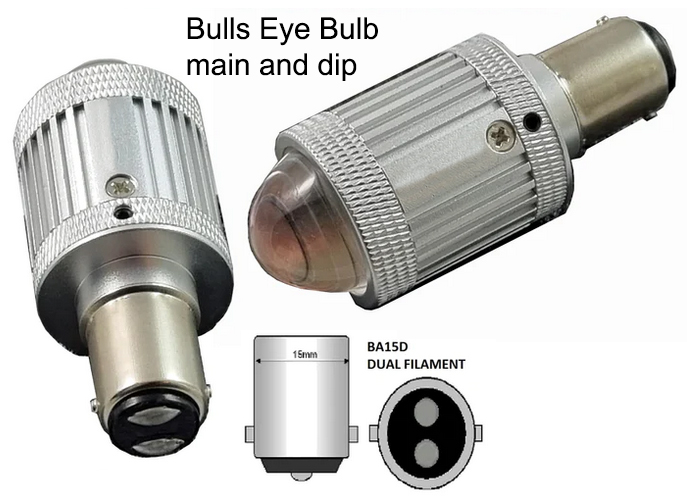

Today, the most effective replacement headlamp LED bulb is the "bulls-eye" projector version, a version of which is fitted to many modern cars. This type has the distinct advantage of not needing a reflector - nor any complicated form of glass lens in front of it, it's an entirely self-contained unit. Until recently, reflectors in perfect condition were essential - and the only way of achieving that was to have them re-silvered regularly and kept clean. During the 1960s, and early 1970s - and with my 1930 Chummy in daily use, with standard R47 headlamps, perfect reflectors and 35-watt bulbs -  there was sufficient output for pressing on along country roads. There was no dip facility, but at the speeds run, this hardly mattered. The problem was, of course, that the dynamo could not keep up and, with the ammeter showing a healthy discharge, the battery was flat within a few hours.

Simply replacing your ordinary bulbs with LED ones that fit the holders will give a brighter beam - but one that will, inevitably, be unfocused. As originally equipped, the reflectors had bulbs with their filament at the "point of focus" to give a theoretically parallel beam. An LED bulb outside of this position will produce a beam that, though brighter, is scattered and - in the experience of many - pretty well useless. Other than the bull-eye type, the only LED headlamp bulb I know of to have performed well - and only available in a fitting to suit the Ruby - is the one shown in illustration B below. It takes the form of a narrow rectangle with one LED on top and another beneath to give high and low beams. With good reflectors, these give an excellent, well-formed and bright beam. Unfortunately, this bulb appears to be currently unavailable (early 2024) in the Ruby P15D-30APF 'big flange' fitting - though this might change as supplies become available again. Happily, the bulls-eye type can be had in BA15D (the standard twin-base contact, 15 mm diameter body with level pins) and the P15D-30APF for some models of the Ruby. The special double-filament Lucas/Graves bulbs used from 1931 are replaceable by the "Bosch" version of the bull-eye bulbs - there is just enough room, a few mm, behind the glass for them to fit. This brings us to bulb holders and getting the bulb fitting correct. On an A7 the common fittings are:

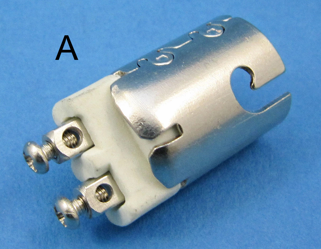

BA15S: a bulb with a 15 mm diameter body, level pins and a single contact (originally known as Single Centre Contact SCC)
BA15D: a bulb with a 15 mm diameter body, level pins and a double base contact.
If your bulb holders are a single-contact type, they will need to be changed - and replacements in a variety of types are available from several suppliers including this double-contact, parallel-pin holder (picture A) from https://www.autoelectricsupplies.co.uk/p/ba15d-parallel-pins
How is the double-contact holder fitted? In one case the writer managed to bend back the metal tabs holding the ceramic contact unit and fit just the latter into an existing holder. If this is not possible, the original holder will have to be swan off and the hole enlarged to fit the new. Cutting the old off with a Junior hacksaw is easy, but how to enlarge to the 17 mm diameter of the new holder in a rather delicate reflector? The writer managed this by using, with great care, an adjustable reamer and taking very small cuts until the new holder was a snug fit. Next, how to retain the holder: solder can be used, though this can be tricky and a far easier way (with which the writer has had success) is to use Araldite or a similar two-pack adhesive. If everything is cleaned thoroughly - finishing with alcohol - the job will be successful. Before getting the glue ready, remember that the bulls-eye bulbs need to be fitted so that the black line on their body is exactly at the top. With the Araldite still flexible, the holder can be positioned. IMPORTANT: If your reflector is the push-in-and-twist type ( like an R47) you'll need to install it into the headlamp shell and make a mark indicating the 'real' top. Next, with the bulb fitted into its holder, position it so that the black line on its body is at the top and mark this on the holder. With the glue still not set, the two marks can then be aligned--but, if the positioning is found to be slightly out, bulbs are provided with a small hex-head screw that allows the body to be twisted a little for final adjustment.

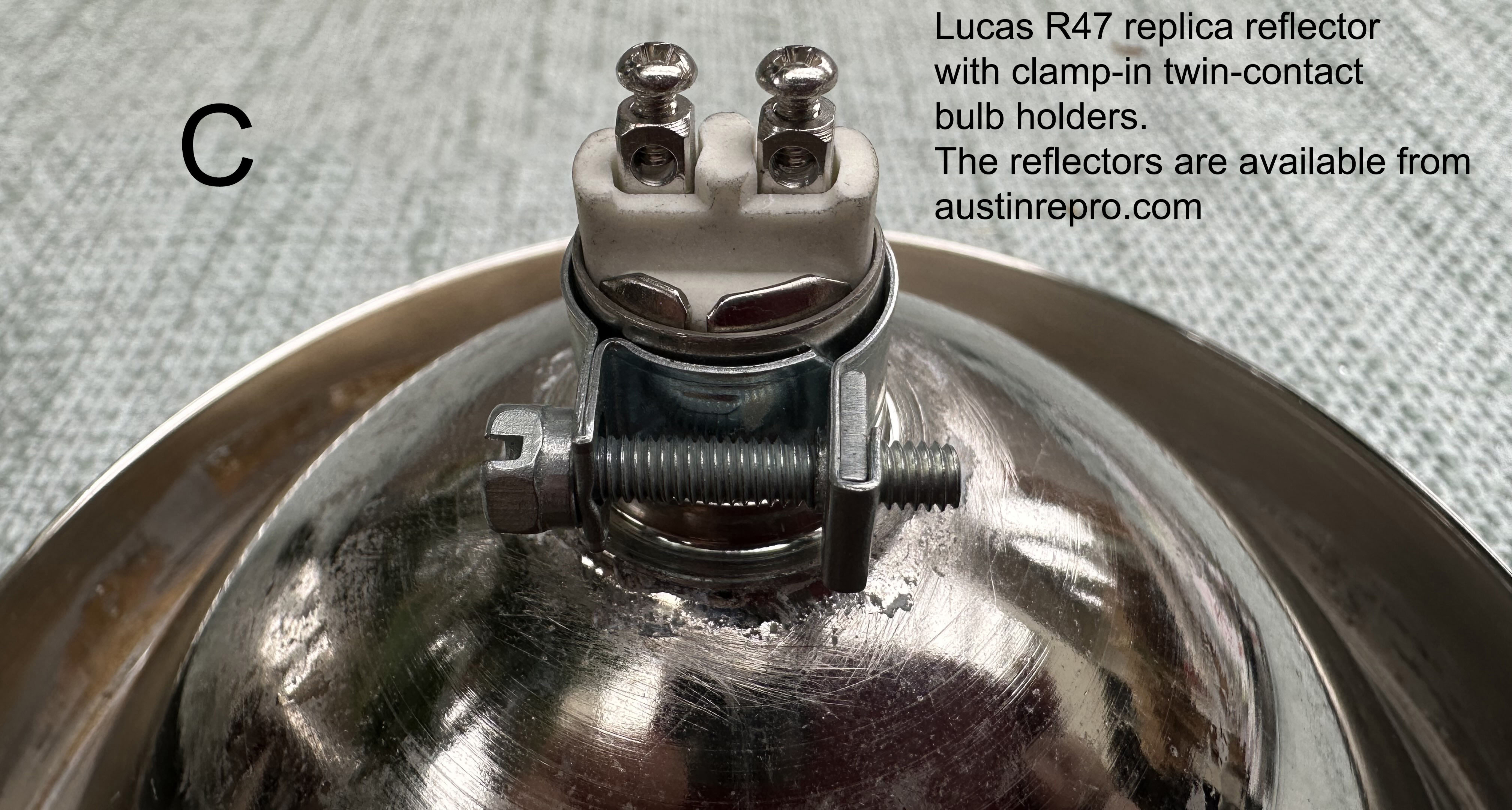

If you have early R47 headlamps with deep-rim reflectors and want to save a lot of time and trouble, austinrepro.com might be able to supply new reflectors with handy, drop-in twin-contact (BA15D) bulb holders. If you can, especially with 6 volts and LED bulbs, wire all the earth points back to the battery and not the car body shell.
