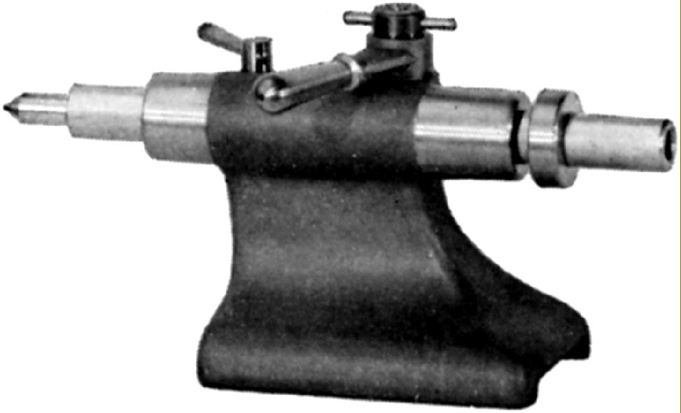

 Tailstock No. 39 - an unusual "spring-actuated" type - with a horizontal lever to withdraw the spindle. This version had a reduced barrel travel of 70 mm - but the operating arm could be adjusted to a convenient operating position and an adjustable stop collar was fitted.

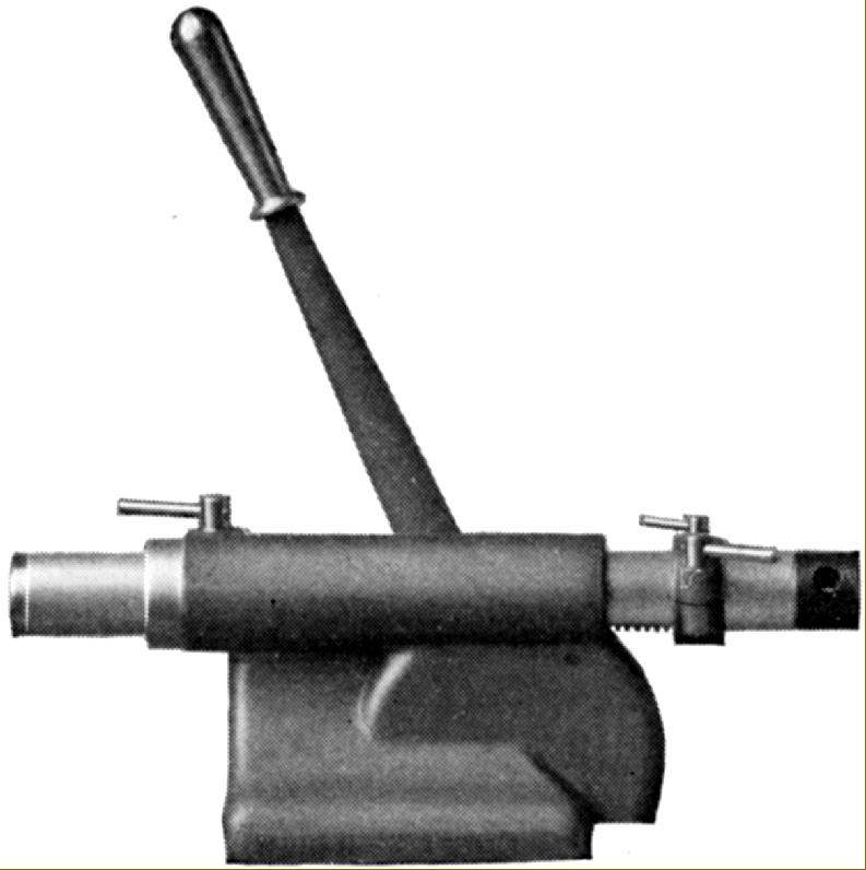

  If a really heavy-duty tailstock was required the makers recommended the No. 40, a lever-operated model with 100 mm of barrel travel and able to carry draw-in collets of 14.5 or 16 mm bore. When fitted with a vertical lever this tailstock became the No. 41
Tailstock No. 41. Identical in specification to tailstock No. 40 but with a vertical lever

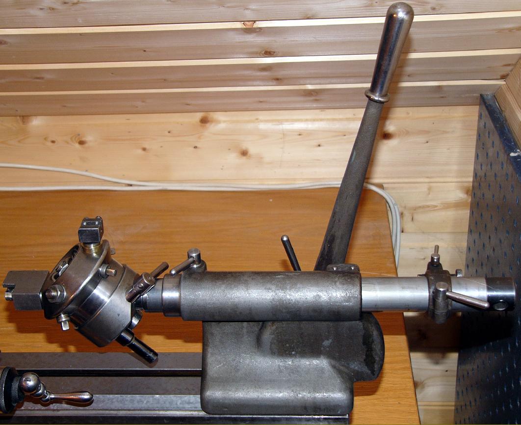

 Tailstock 42 Both No. 40 and 41 tailstocks could be fitted with a (draw-tube-held) 4-station indexing turret head (No. 90) for light repetition work and, when so equipped, were known, respectively, as the No. 42 and No. 42a. The inclined head was bored to take 18 mm tools, hand to be hand unlocked, indexed and locked through each position with a small lever provided to release the pawl.

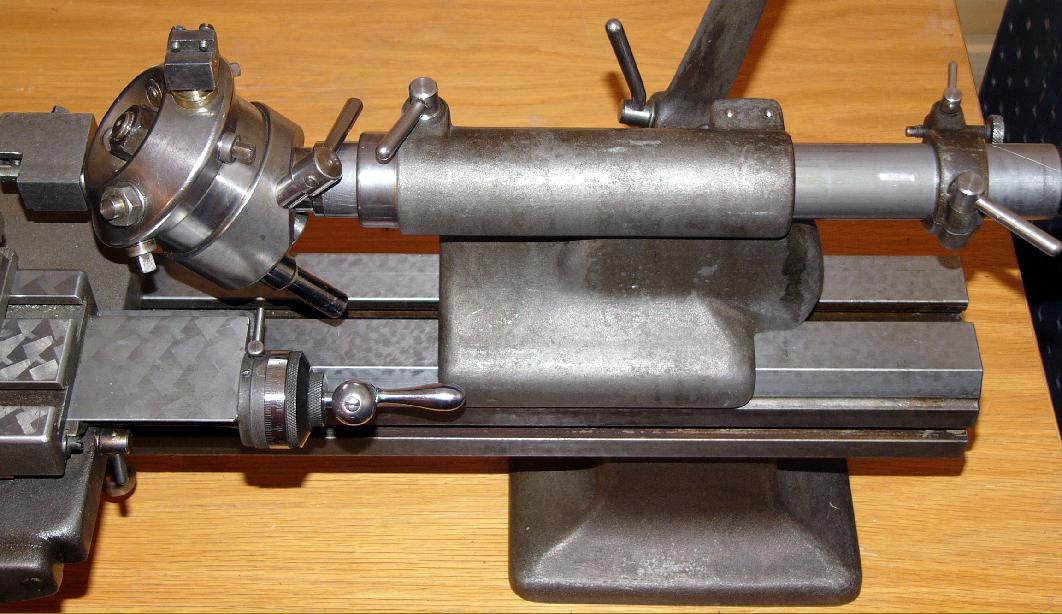

Tailstock 42a Horizontal lever with indexing capstan head No. 90

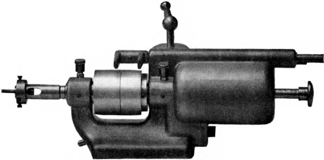

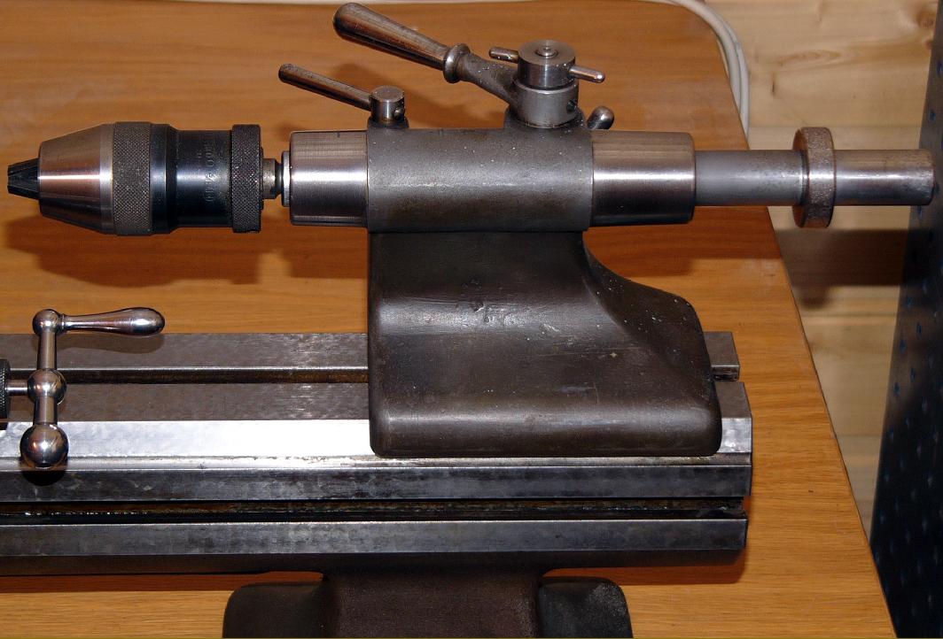

 Other "tailstocks" were more complex - and should really be described as powered drilling attachments. No. 43 (above) was a substantial unit with a 6,000 r.p.m. plain-bearing spindle moved through its 80 mm of travel by lever action and rack-and-pinion gearing. The end of the spindle was bored to accept collets up to 6 mm capacity (No. 43a) and a single 50 mm diameter by 20 mm wide pulley was fitted that, to avoid the transmission of belt pull, ran in its own ball bearings. A peg on the inside of the pulley drove the spindle.
