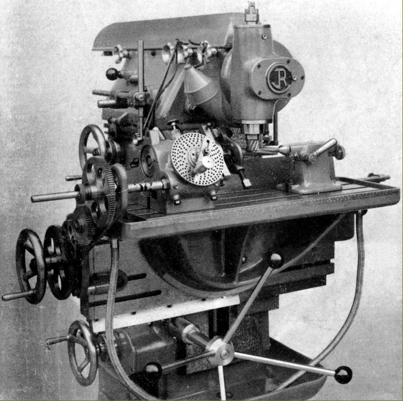

S.A.B.C.A. Type J.R.C.2 miller with  a powered dividing head mounted  on the table
