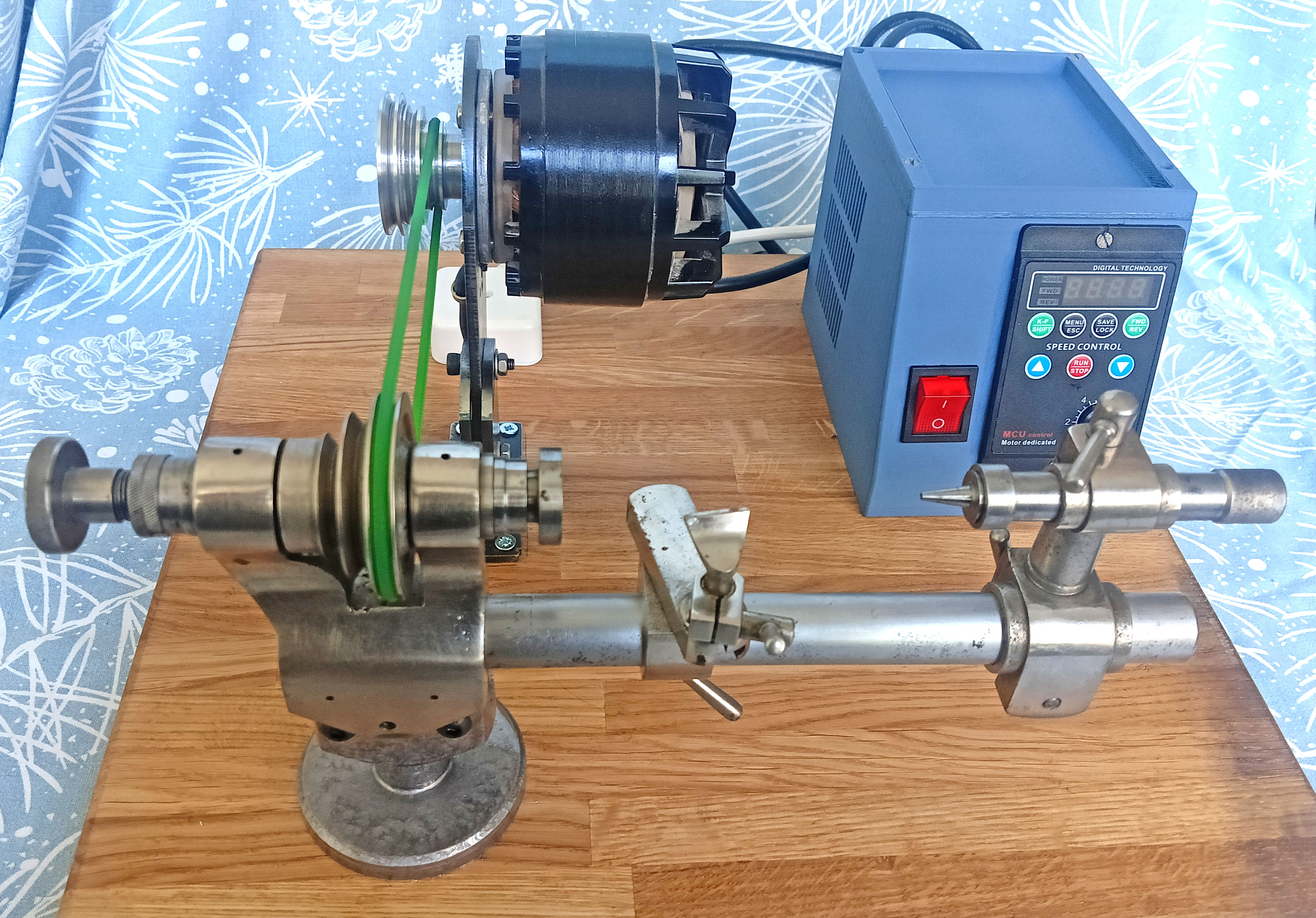

By an unknown manufacturer, the first lathe shown below is a WW-type (Webster Whitcomb) watchmaker's lathe, Russian made, sold as the Model C-95 and current during the 1950s.
The second, lighter, round-bed example, also Russian made (but again by an un-named maker) is a lighter Geneva type and known to have been labelled as the type ATM-2
The WW example has the usual-for-the-type 50 mm centre height, a flat-topped bed with bevelled edges, a robust build and an excellent finish - making it distinctly different to the much lighter "D-bed"
Geneve type as made, for example by the Swiss Bergeon Company. Likely to have accepted 10 mm draw-in collets in the headstock spindle, and 6 mm in the tailstock, this example of a Russian-made lathe looks to be of excellent quality. The screw-feed compound slide rest assembly has twin T-slots to give a choice of location for the toolpost, and enclosed feed screws - safe from the wearing effects of swarf and dirt. Good-sized, zeroing micrometer dials are fitted and have knurled rims for a better grip. Unlike most lathes of a similar type, this example is fitted with headstock bearing oilers.
The Geneva type ATM-2, which takes an 8 mm collet, looks to be less-promising in terms of build quality and cosmetic finish - but would have sold at a much lower price and proved adequate for a wide range of watch-repair jobs.
