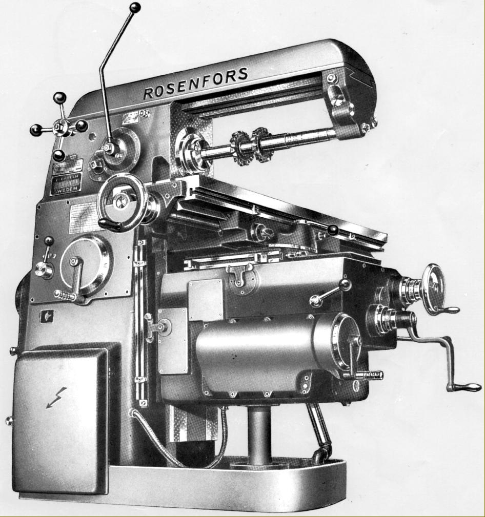

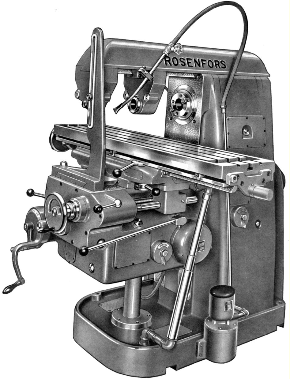

Rosenfors Type RFE Horizontal with overarm brace in place

Rosenfors Type RFE showing the spindle-speed and table-feed dial-type speed control wheels

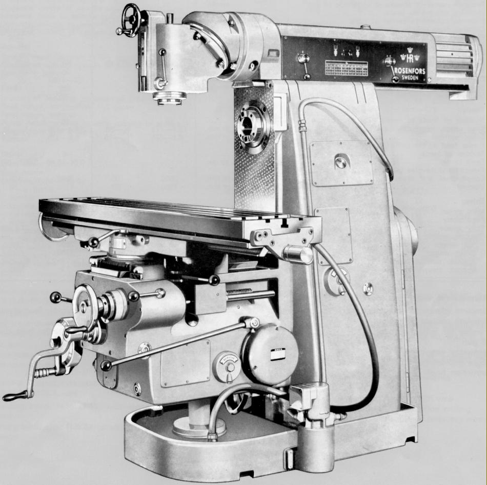

Rosenfors Type RFV-M Vertical
