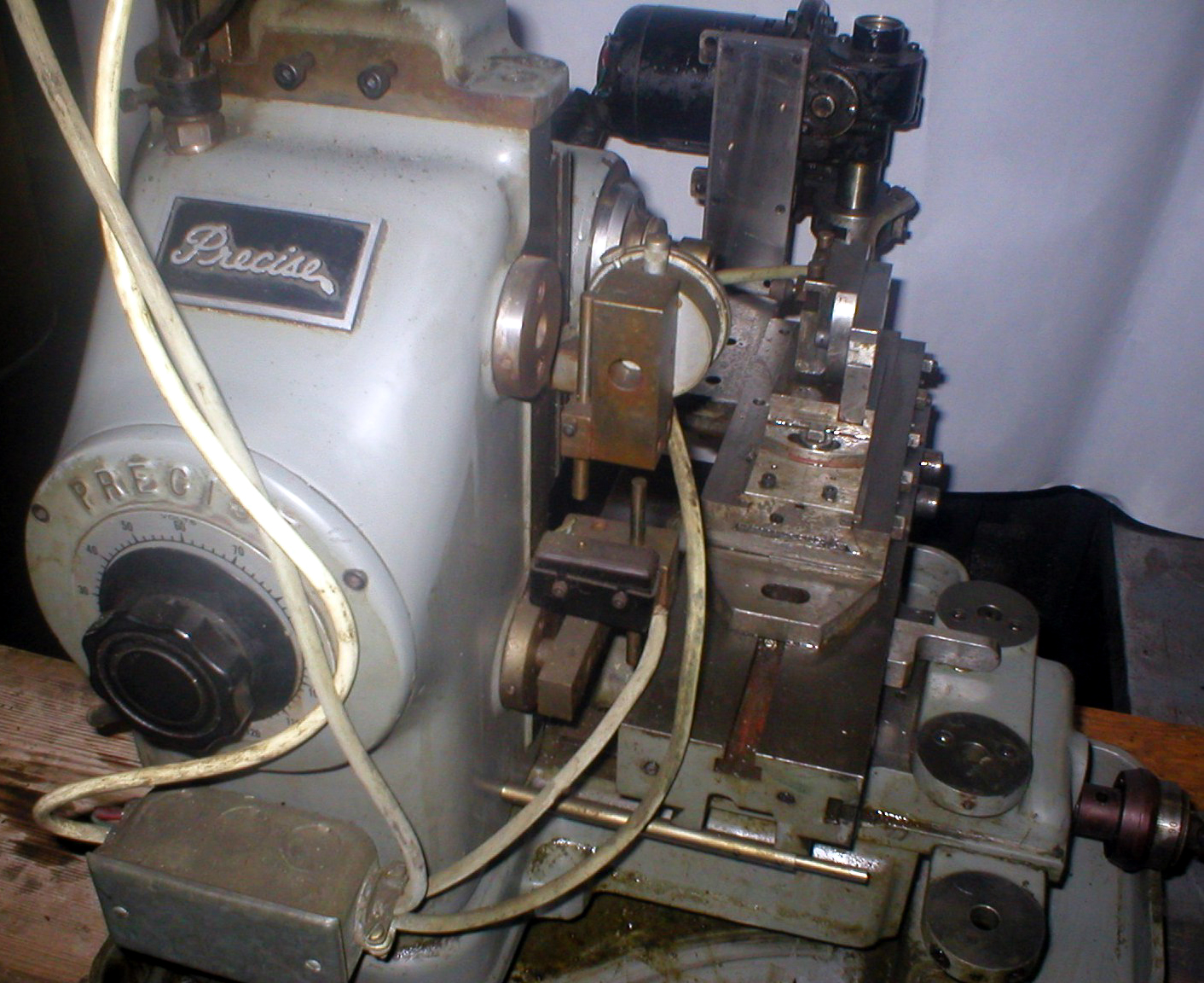

Precise Model "Indicator" Note the T-slot in the side face of the head
The"Commutator Undercutter", a model fitted with a lever-feed to the table's longitudinal travel and a special table-mounted assembly that allowed electric motor commutators up to 7" long to be mounted either on centres or in special brackets for centreless shafts.
Precise Model "Indicator" with detachable brackets mounted to carry dial indicators ion all three axes of travel. Note the T-slot machined into the head's left-hand face. Various jigs and adapters are mounted on the table
