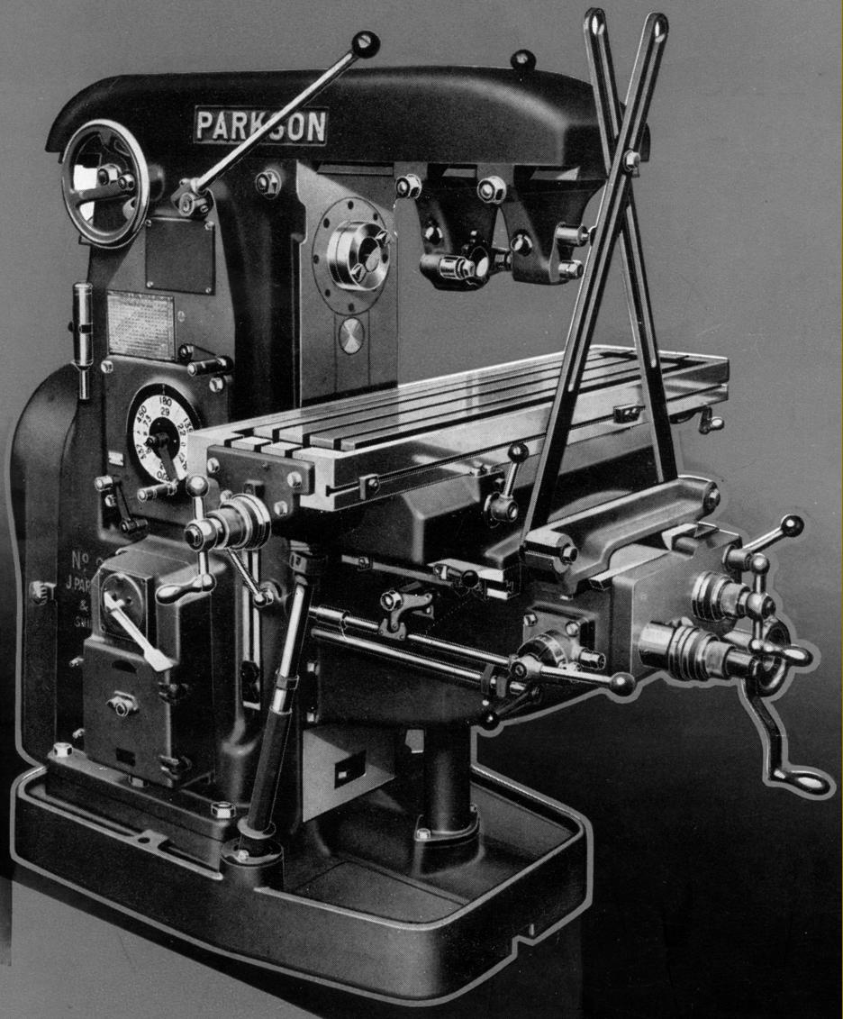

A long-established British machine tool company, J. Parkinson & Son (Shipley) Ltd. was active from the late 1800s until the 1980s. Apart from absorbing the Sunderland Gear Planing Company, and making a number of flat-belt drive lathes (probably until the end of WW1) during that time their main production was of conventional milling machines of the plain horizontal, universal horizontal, vertical, production and a semi-toolroom universal type that all sold using the "Parkson" brand name. Very similar machine stayed in production for many decades with even the last models made, the M1200, M1250 and M1500 types still remaining distinctively Parkson in style Plain and Universal No. 2 millers - 1930s and 1940s In addition to the long-lived No. 1 and No.1N machines, one of the most popular Parkson models - and a machine that found a world-wide market - was the No. 2. It was manufactured from the 1930s until the 1960s and, like the competing Cincinnati No. 2 MI miller, underwent a steady if unspectacular programme of development. It was sold as the 2Np Plain Horizontal, 2Nu Universal (with a swing table, a standard-fit 12" dividing head and a built-in crane for mounting accessories) and the 2Nv vertical. Identical in all respects - save for their tables - the early Plain and Universal models were designed to be driven by a 2.5-inch wide flat belt from either a 4 h.p. motor held on an adjustable platform within the column base, or (picking up on the 12-inch diameter input pulley) from line shafting. The drive passed though a lever-operated, multi-disc clutch with a brake that operated automatically as the drive was disengaged. Built into the column, the speed-change gearbox held gears and splined shafts that were hardened and ground, running on ball or roller bearings and lubricated by a pressure pump with a flow indicator on the right-hand face of the column. Hardened on its 50 INT nose, ground and supported in two precision taper-roller bearings at the front and a roller race at the back, the spindle had 12 speeds that ranged from 29 to 775 r.p.m. - a set that was adequately for the cutting tools then in use. Speeds were changed by the juxtaposition of two levers together with a rotary control - the latter with a speed-indicator plate - on the left-hand face of the column. Instead of a single, start/stop lever that could be adjusted for position, the Parkson had two, with one mounted at each side of the column. Continued below:
Parkson No. 2 Plain Horizontal as manufactured in the late 1930s into the 1940s
Continued: Fitted to the Plain model was a 52.5" x 12" table, that on the Universal being 56" x 12.5" and able to be swung 50° each side of central. The longitudinal travel on both types was 28", across 10" and vertically 18" - with twelve rates of feed provided from 0.5" to 10.5" per minute for both horizontal movements and at one-half that rate vertically. The longitudinal feed was selected and engaged by a single directional lever on the left of the saddle while vertical and across movements used a single lever on the left of the knee for selection (lift for cross, press for vertical) and a separate lever, to the right of the right of the knee, to select direction. Rapids were fitted to all travels at the rate of 100" per minute for both horizontal movements and at 50" vertically. A single lever to the right-hand of the knee was used to engage the rapids; upon depressing it (and keeping it depressed) a contactor was closed, the power-feed clutch disengaged and the rapids safety friction clutch engaged. All feeds were driven from the main motor through a complex gearbox and drive-shaft system. In addition to the usual adjustable automatic knock-off stops on each axis of table travel, safety limit stops (and a mild steel 28-30 ton shear pin at the right-hand side of the knee bracket) were also included - ensuring that a careless operator could not wreck the machine by leaving a feed unattended. Part of the standard equipment fitted to the Universal model (and optional on the Plain) was a power-driven 12" Universal Dividing Head with a 1.125" spindle bore with a No. 10 Brown & Sharpe taper (the usual fitting for heads of this size). Able to hold just short of 26" between headstock and the lift-lower-swivel tailstock, the unit was fitted with a dividing plate on the nose for simple direct indexing when milling squares and hexagons, etc., and a double-sided index plate by which means all divisions up to 60 could be obtained as well as all even numbers and those divisible by 5 up to 120 and all common divisions up to 400. By using differential indexing, other divisions could also be obtained. The head sat on a reversible base plate, allowing it to be set at right-angles to the table, and could be swivelled from 5° below to 50° above horizontal so allowing spirals to be milled at any angle between the two settings. For milling spiral pitches with a lead of less than 0.1" the worm gear could be disengaged and the dividing head spindle connected to the table feedscrew by changewheels mounted on a quadrant arm - thus increasing the rate of rotation of the spindle in relation to the speed of table advance and so allowing very fine threads to be generated. Continued below:
