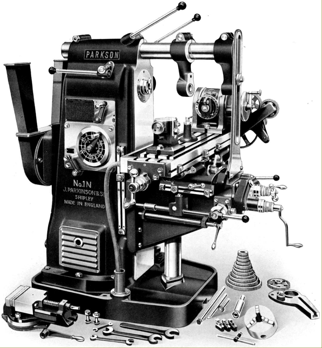

Parkson No. 1 as made  during the 1930s. Note the round overarm - typical of the period - and the general arrangement  of the machine and its controls that both remained unaltered through its production life
Parkson No. 1 as made from the late 1930 until the late 1940s. The only significant alteration was the use of a very much more rigid overarm
Parkson No. 1 as manufactured from the early 1950s onwards. Although all-new in terms of major castings, this model was almost the same mechanically as earlier versions. Electrical controls were much improved - a built-in motor drive now being standard - and, not before time, larger micrometer dials fitted.
