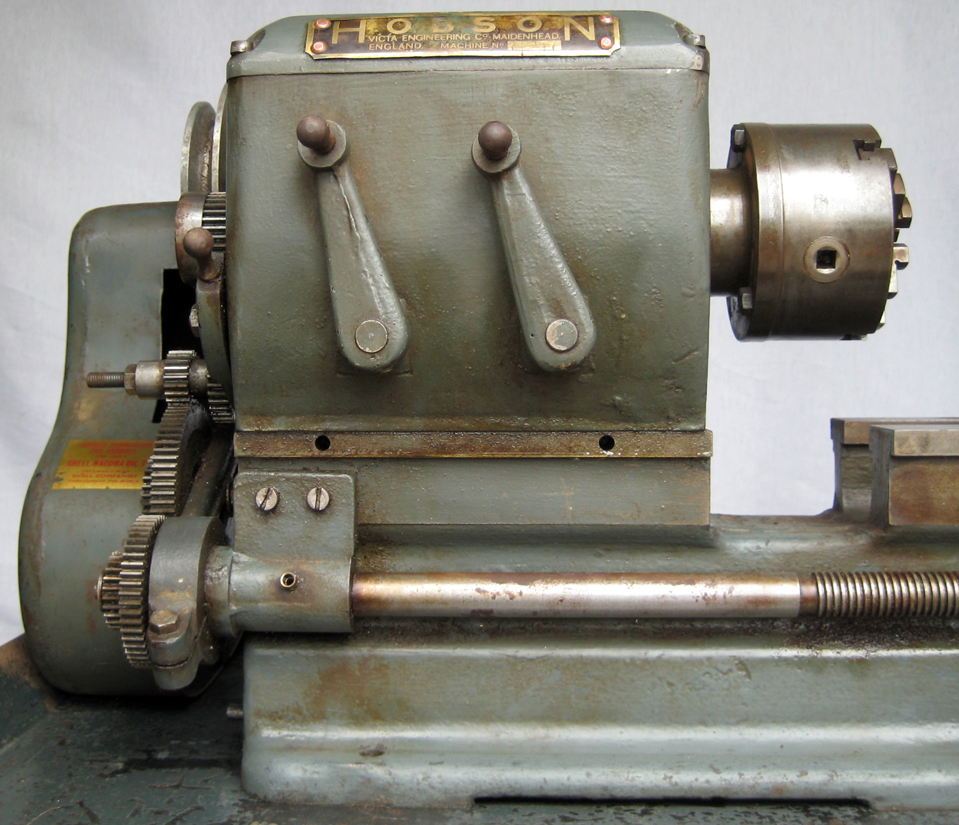

From the tailstock end the Myford-like appearance of tailstock, carriage and leadscrew handwheel is evident. A useful T-slotted cross slide was fitted as standard as were zeroing micrometer dials.

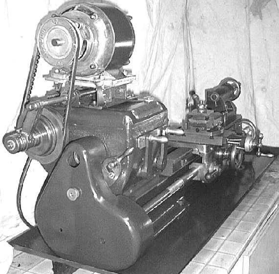

Although fitted with an expensive geared headstock in this end view two cost-cutting features are evident: the securing of the changewheel guard by a single stud and hand nut (instead of being properly hinged mounted) and a tumble-reverse lever that required the use of a spanned before the leadscrew rotation could be reversed.

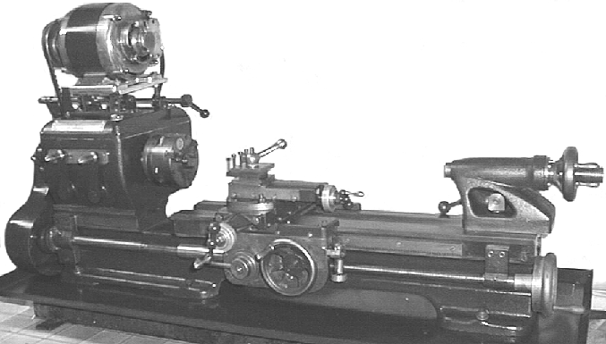

The Hobson H7 above, with a Serial No 7/101 may well be the very first (makers often favoured 101 or 1001 as a starting point) and possibly experimental model with a neatly-mounted spindle clutch assembly.  This example was found complete with a Burnerd 3-jaw Griptru chuck, two 4-jaw chucks, a faceplate, vertical milling slide, fixed and travelling steadies - and a rear toolpost.

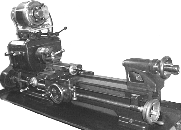

A remarkably fine and original Hobson - probably the best surviving example - which remained in the hands of one family for over 50 years
