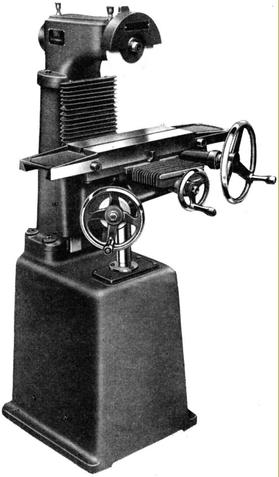

The basic  Eagle Model 1 with table travels of 12" x 6" and bolt-on head
Eagle Standard Model No. 3 with one-piece column and head and a 21" x 6" table with 18" of longitudinal travel

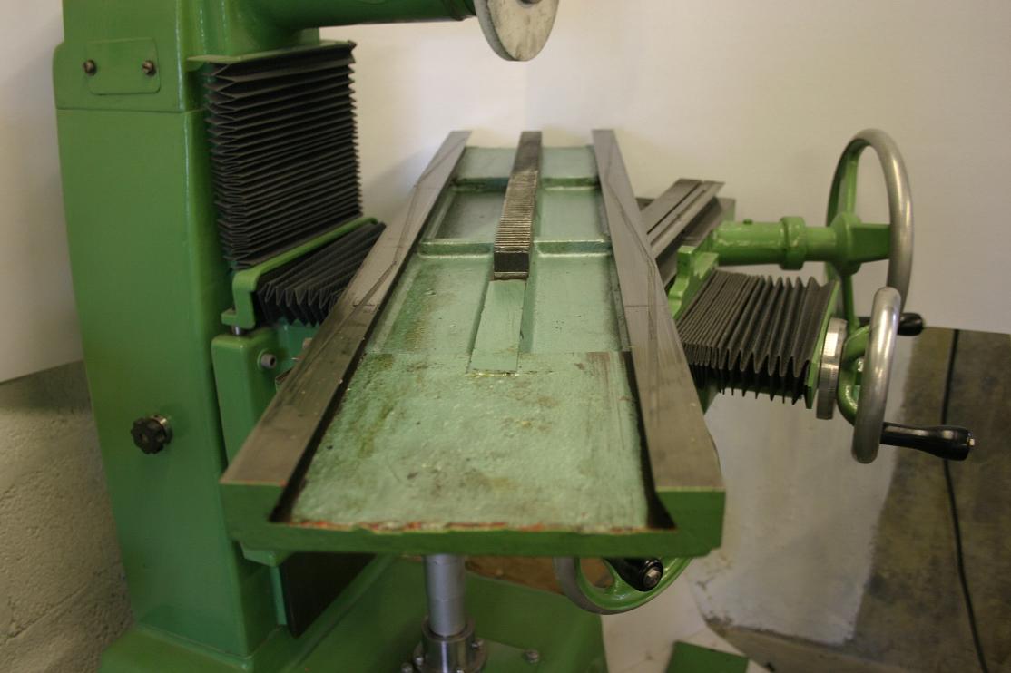

Underside of the table

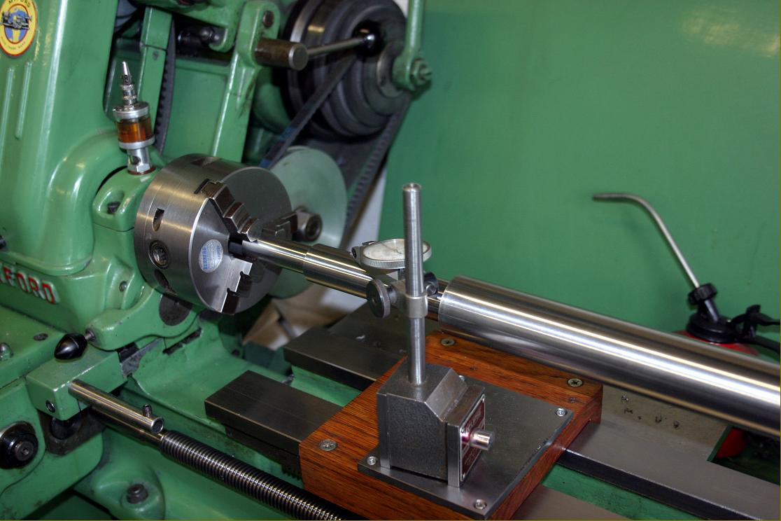

Making a new spindle for the Eagle
