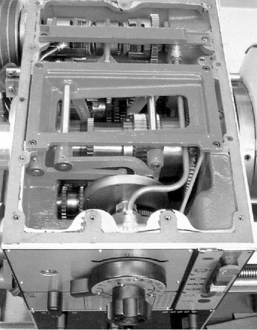

Fitted with hardened and 'Reishauer' gears mounted on shafts rotating in Gamet precision bearings - a double row at the front and a single row at the rear - the headstock was supplied with oil from a belt-driven pump attached to a separate tank held within the cabinet base. The spindle was bored to pass 65 mm (2.5") and was fitted with a hardened No. 8 D1 Camlock nose and a reduction sleeve to accept a No. 5 Morse taper. 18 spindle speeds were provided from either 40 to 2000 rpm or, optionally, 31 to 1600 rpm from an easily-changed 7.5 kW (10 hp) motor fastened to an adjustable plate bolted to the back of the bed immediately below the headstock. Separate Matrix-manufactured clutches for forward and reverse operation were fitted to the headstock input shaft but, unlike the M400, an electro-magnetic spindle brake (an essential feature on a modern, high-speed lathe) was only supplied against an extra charge; two concentrically mounted, rotary selectors with unambiguous markings and positive indents selected the spindle speeds.

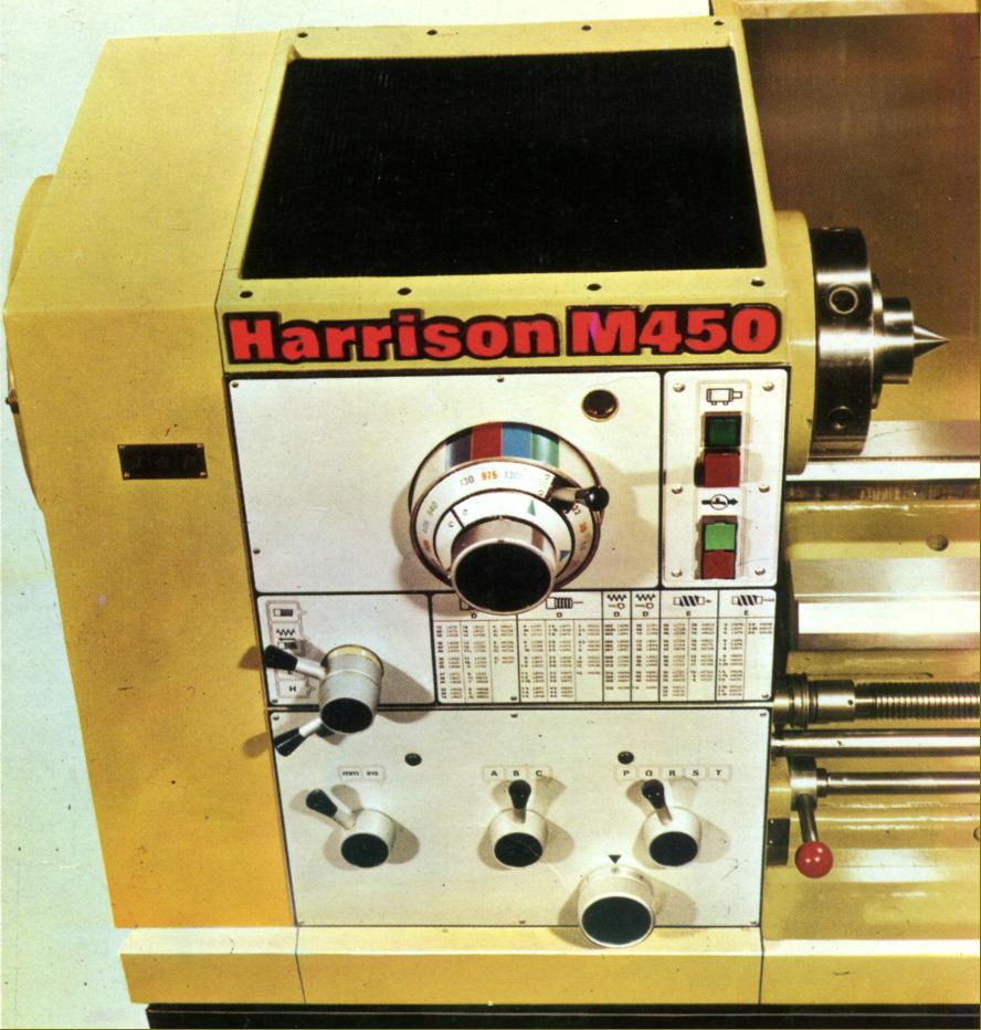

Lubricated by splash, the screwcutting and feeds gearbox (with induction-hardened gears) was controlled by three smooth levers - difficult to operate with oil hands - and a single rotary selector. On early machines with the push/pull button on the apron 38 English threads from 2 to 72 t.p.i. were listed together with 40 metric from 0.4 to 14 mm, 18 metric module from 0.3 to 3.5 mod and 27 Diametral from 8 to 60 DP. Later machines, with the improved apron and single-lever control of the power feeds listed 78 metric pitches from 0.2 to 14 mm pitch, 79 English threads from 2 to 84 t.p.i., 47 Module pitches from 0.2 to 3.5 MOD and 47 Diametral from 8 to 64 DP. The feed to the leadscrew incorporated a torque-limiting mechanism and the gear train was fitted with a shear pin. On early lathes power feeds ranged from 0.002" to 0.032" (0.0508 mm to 0.8128 mm) sliding - and exactly half those for the surfacing rates. The power feeds on later machines (which were identical to those on the M400) ranged from 0.0016" to 0.112" (0.04 mm to 2.84 mm) with the power cross feed set, again, to be one half of the longitudinal rate.

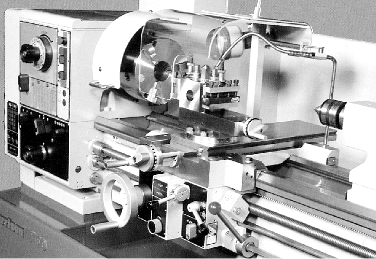

Early M450 with controls using round bars tipped with plastic knobs

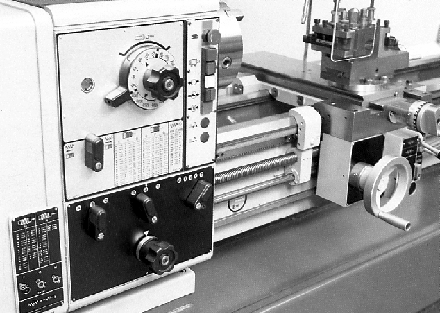

Carriage as fitted to late-model, straight-bed machines, with the hand-traverse hand on the left-hand front face of the apron and a single lever, pointing forwards in the middle, to select and engage power feeds. On the right-hand face of the apron, immediately below the standard-fit dial thread indicator was a gated spindle-control lever that provided electrical stop/start and forward/reverse functions; in addition, an emergency-stop button with a "power-on" light was fitted to the headstock whilst both the electrical isolator and coolant pump switch were mounted on the left-hand face of the stand.

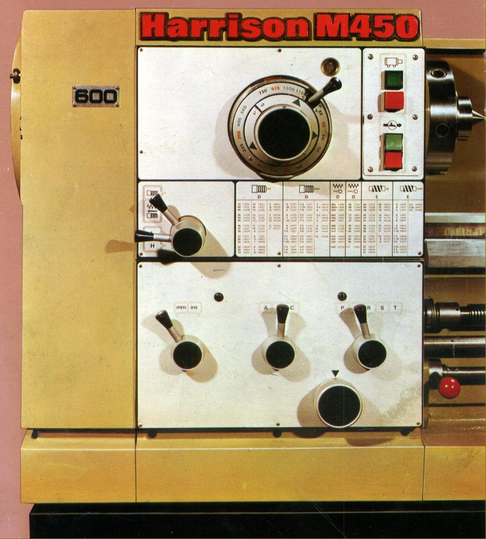

M450 late model: two concentrically mounted, rotary selectors that had unambiguous markings and positive indents selected the spindle speeds. Although electrical control of the spindle was primarily under the influence of a gated lever fastened to the right-hand face of the apron an emergency-stop button with a "power-on" light and stop/start controls were also was fitted to the headstock.
Visible in this picture are the individual forward and reverse clutches on the rearmost (input) and the pipes supplying lubricant from the base-mounted pump and tank.

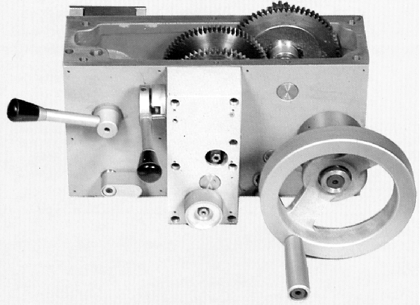

Apron as fitted to the later gap-bed models with the hand-traverse lever on the right-hand side of the front face and single-lever selection and engagement of the power feeds. The double-walled unit was formed to hold a quantity of oil within its base from where it could be pumped by hand to the various spindles and gears - and also to the bed and cross slide ways. On gap-bed machines the carriage-traverse handle (which could be disengaged when using power feeds) was positioned on the right-hand side of the apron, whilst straight-bed models it was on the left. The makers described the leadscrew nut as being of the "floating" type, used to ensure "maximum threading accuracy".

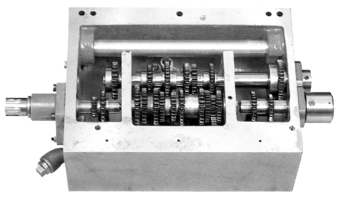

The oil-splash lubricated screwcutting and feeds gearbox was controlled by three smooth levers - which could be difficult to operate with oil hands - and a single rotary selector. Without changing or rearranging any of the end gears (changewheels) 78 metric pitches from 0.2 to 14 mm pitch, 79 English threads from 2 to 84 t.p.i, 47 Module pitches from 0.2 to 3.5 MOD and 47 Diametral from 8 to 64 DP.
