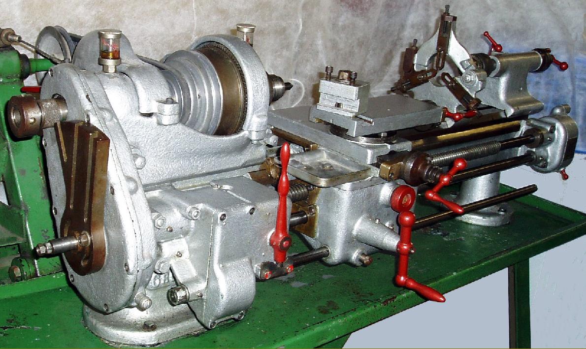

Mk. 2 Cromwell with backgear, screwcutting and power sliding and surfacing feeds. Note the tailstock-end mounted feeds' gearbox with its swing-up cover, the overhung power cross-feed shaft and compound slide rest end plates in bronze.

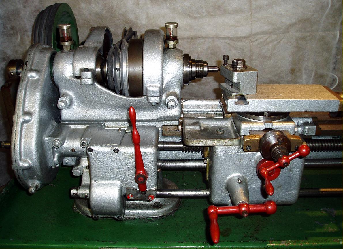

The single lever immediately below the headstock operated individual dog clutches that engaged either screwcutting or the power sliding feed. Its central position provided a neutral with neither engaged
