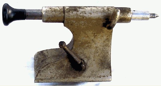

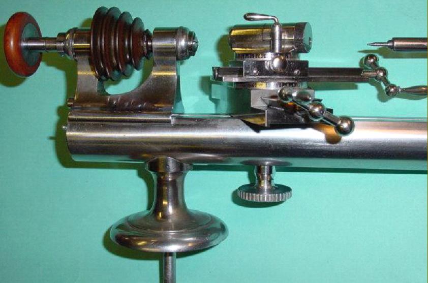

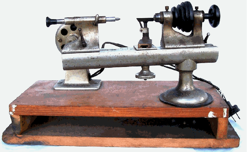

Rivett watchmakers' lathe No. 2. This model had the headstock, toolrest and tailstock aligned by a central slot in the bed - the No. 1 lathes using (in the usual manner) outside bevelled edges. The No. 1 was produced from the early 1890s until late in the same decade with approximately 1000 being produced. No. 2 production followed on and this appears to have been, by the numbers surviving, the more common type - although it was, in comparison with its competitors, a relatively expensive proposition. Watch lathes of this conventional type were produced by all the various incarnations of the Rivett Company: the Faneuil Watch Tool Co., Rivett Lathe Mfg. Co. and Rivett Lathe & Grinder Co.

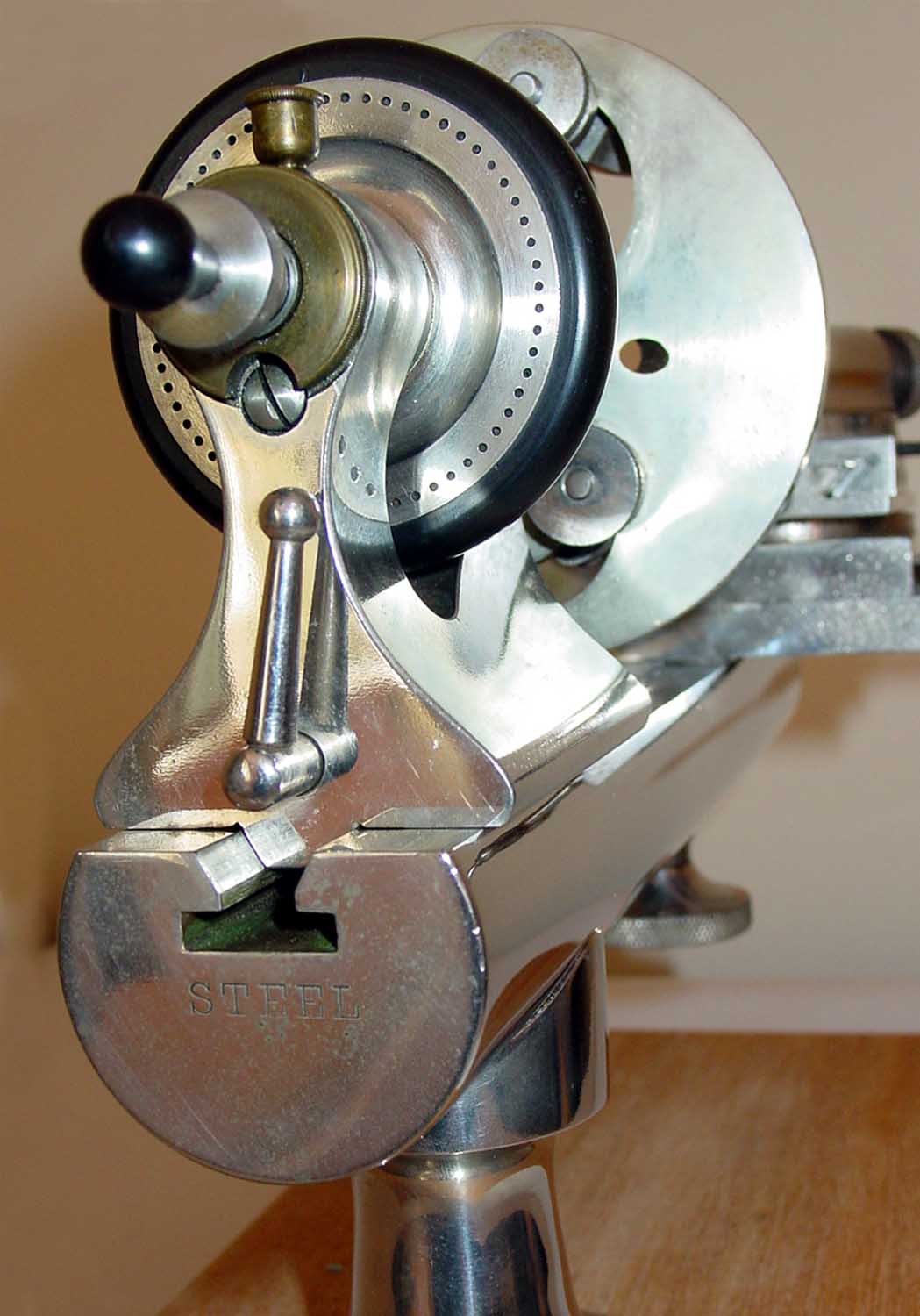

A superb example of the Rivett Type 1C watchmakers' lathe as made by the Faneuil Watch Tool Co. This was identical to the earlier Type 1B (circa 1890 to 1895) but with the word "STEEL" engraved on the end of the bed (shown below) .
Rivett Type 1C watchmakers' lathe engraved "STEEL" on the end of the bed

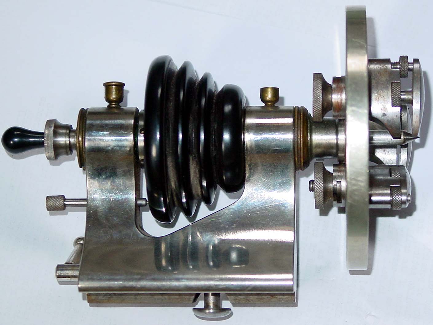

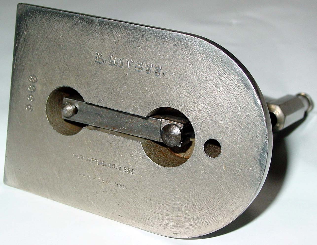

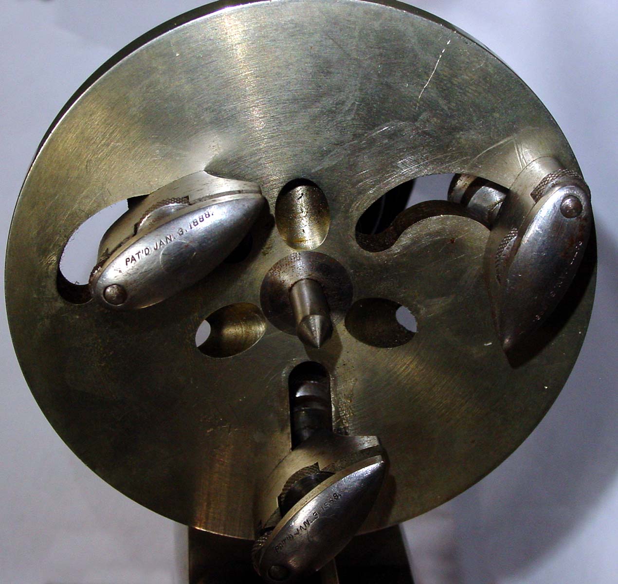

Rivett "Universal Head" - a special, high-accuracy assembly fitted with a permanently-mounted "pump-centre" faceplate made from an especially hard nickel- a tough, rust-proof material with a beautiful appearance. For this unit, the jaws fitted as standard were of the more expensive "Rivett Patent" type - the ordinary collet-mounted faceplate able to be had with standard jaws or, for an extra $5 dollars on the 1902 price of $9, with the "Patent "jaws. The headstock spindle fitted was identical to that used in the ordinary headstock being made from tool steel hardened and ground and running in hardened steel bushes - the arrangement claimed by the makers to be unique to them for this type of fitting.
Faceplate with its special jaws clearly engraved with a patent date of January 3rd, 1888

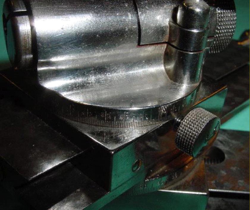

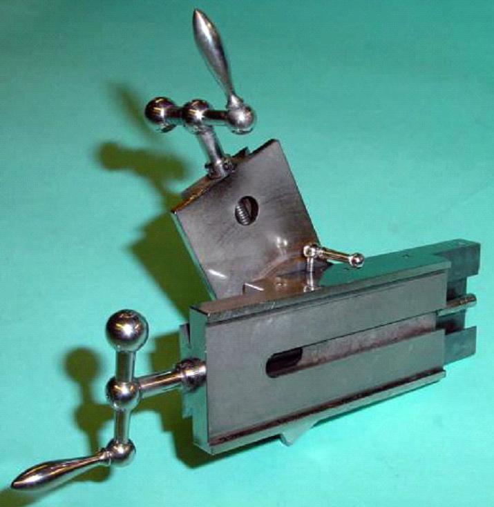

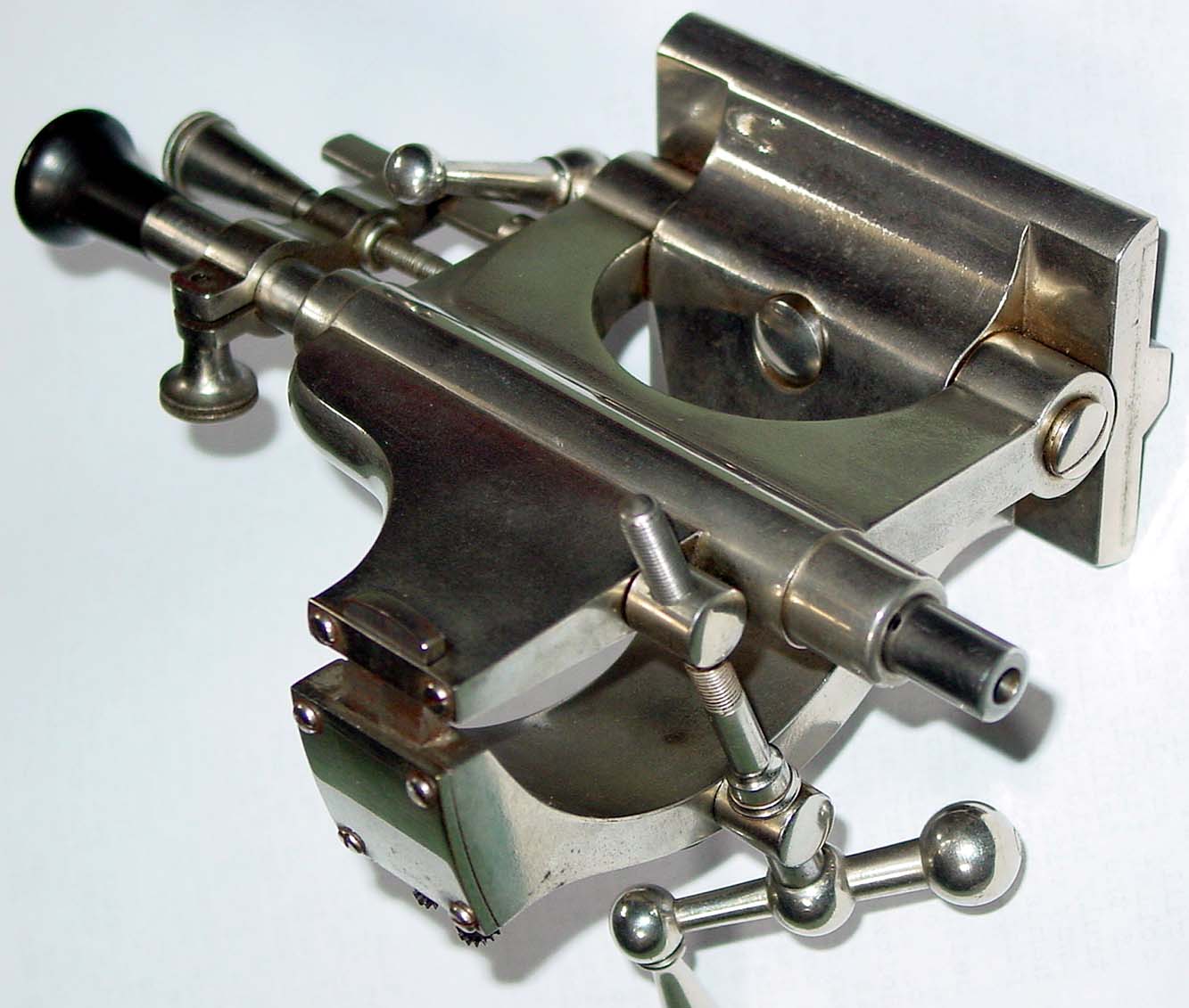

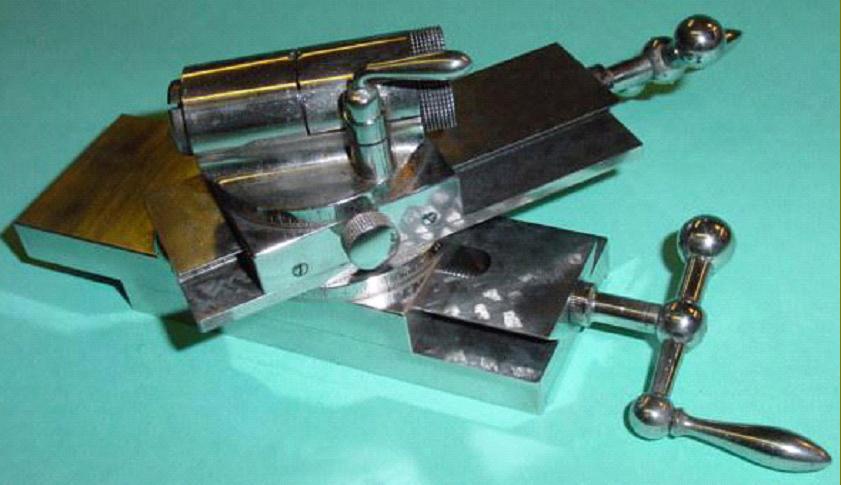

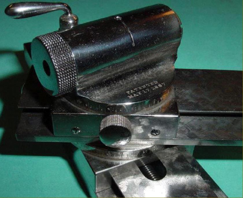

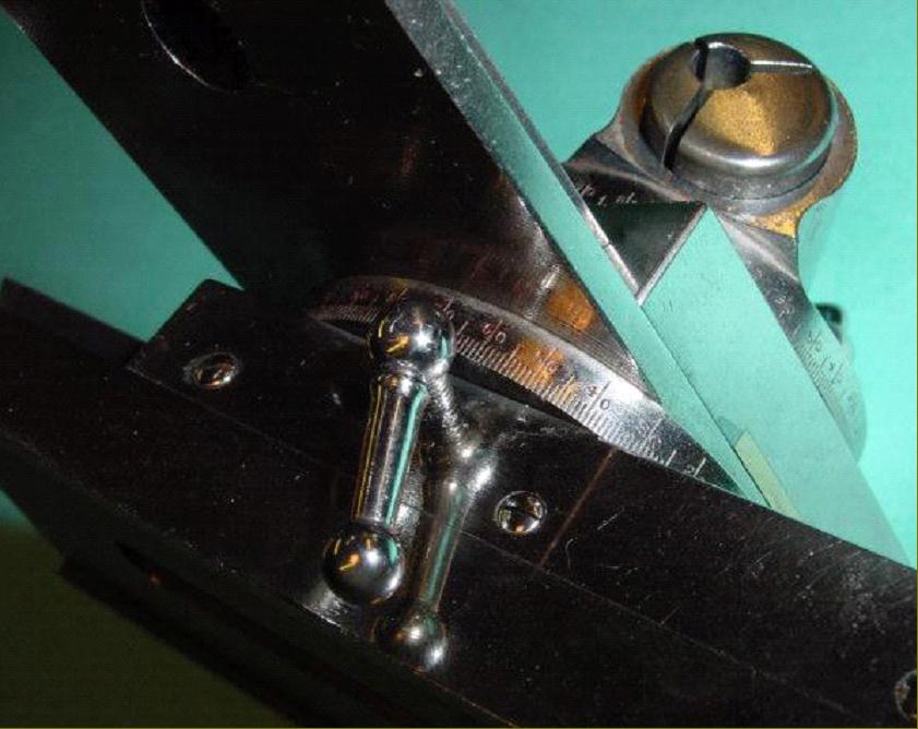

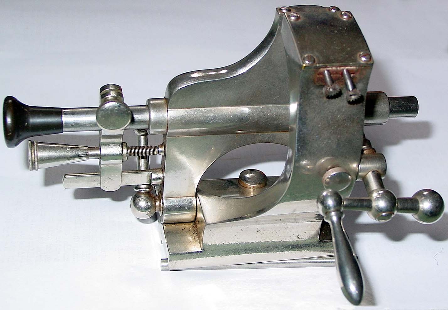

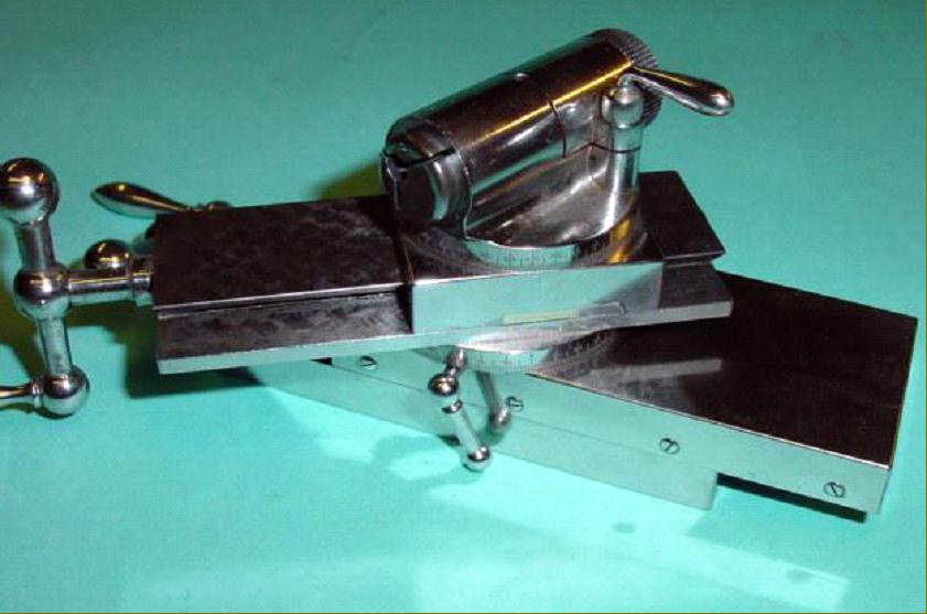

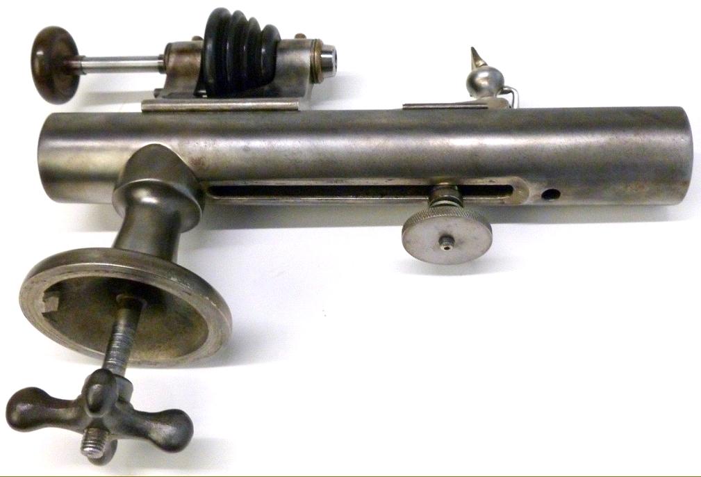

The special Rivett "Jeweling Caliper Rest" with a cross-feed screw

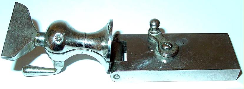

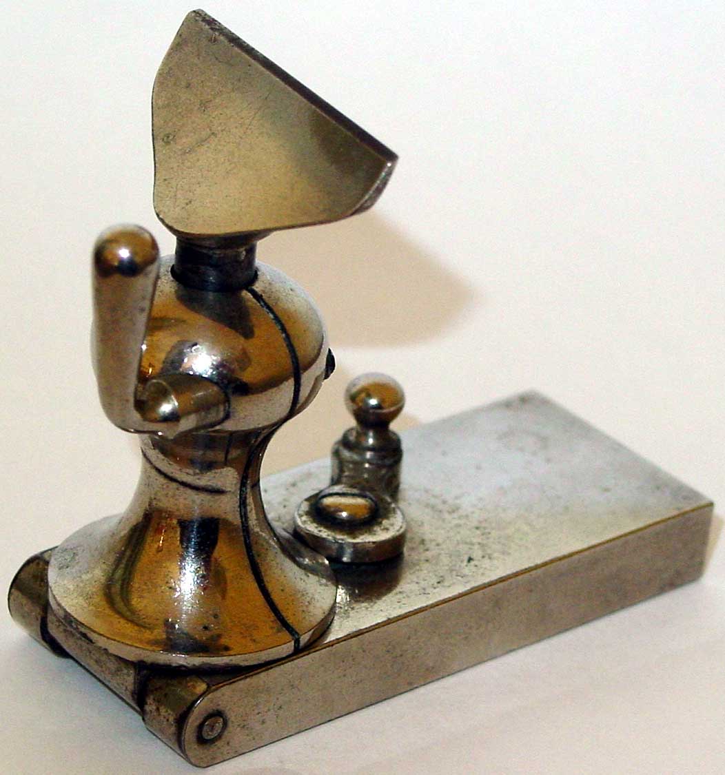

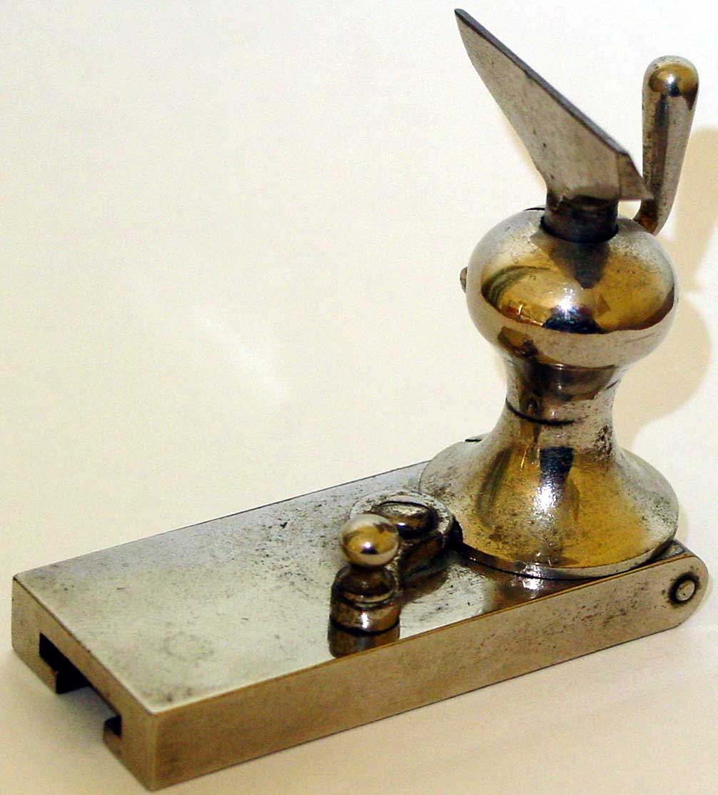

Rivett tip-up tool rest circa 1904
Tip-up toolrest with the quick-release lever shown by the T-rest holder

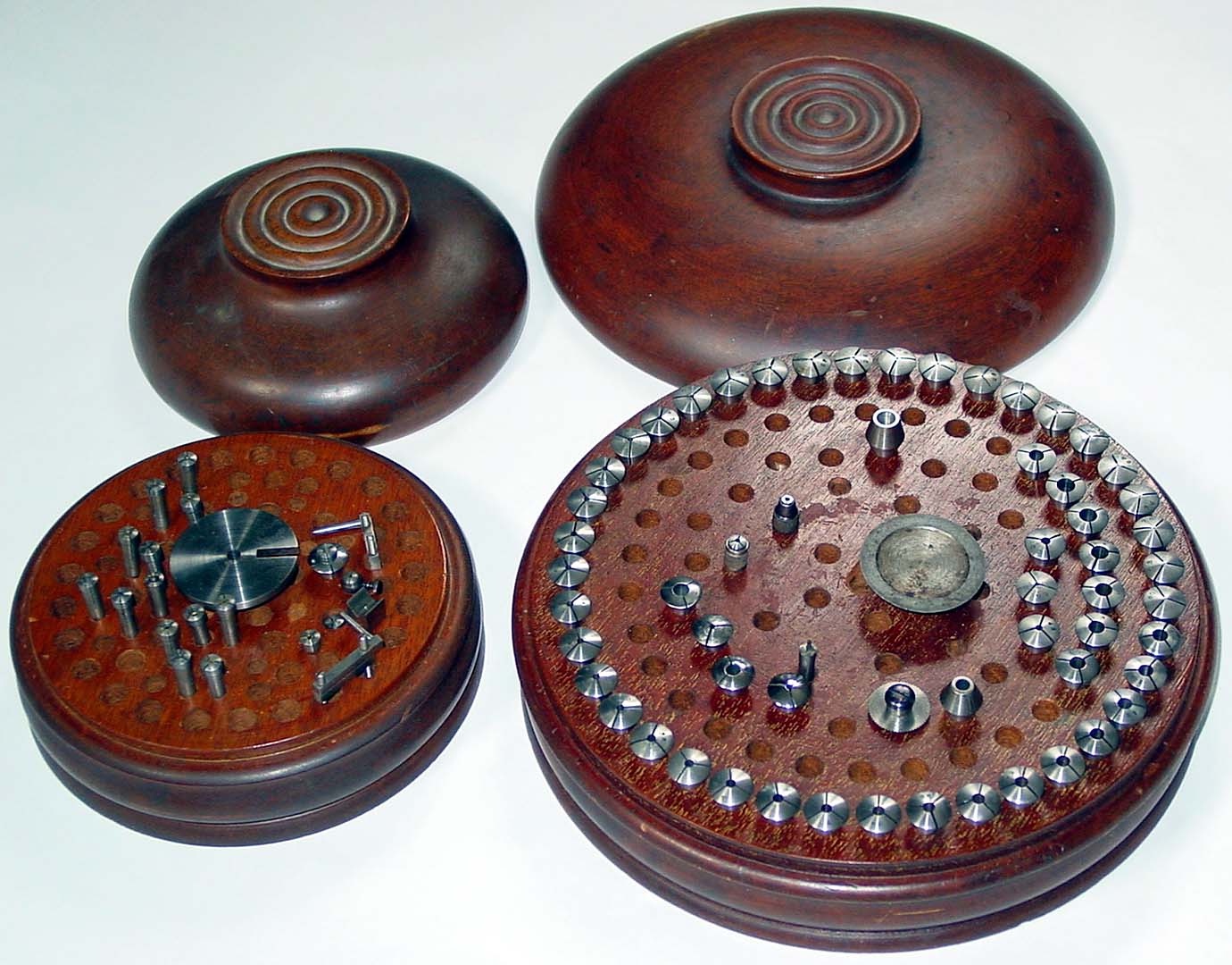

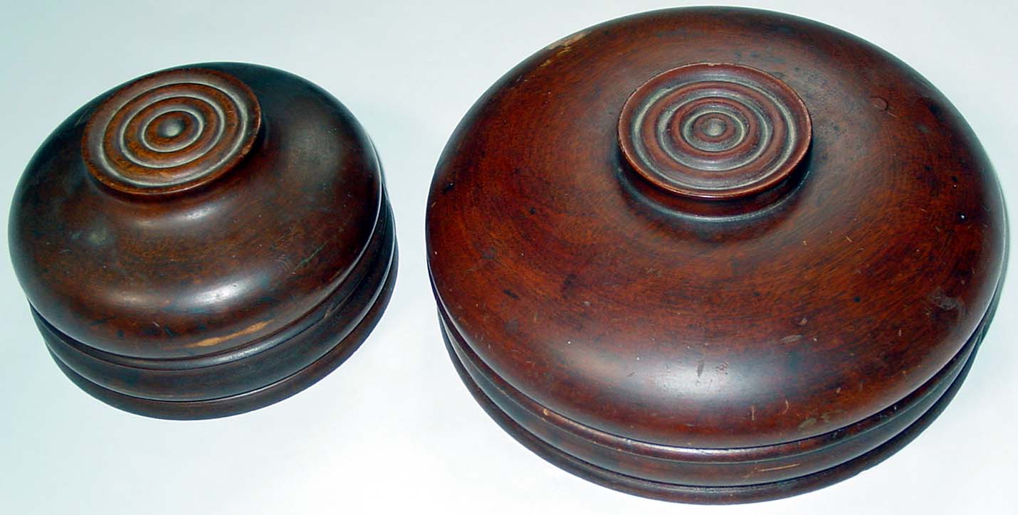

Beautifully presented collet and accessory set
Rivett collet cases closed
