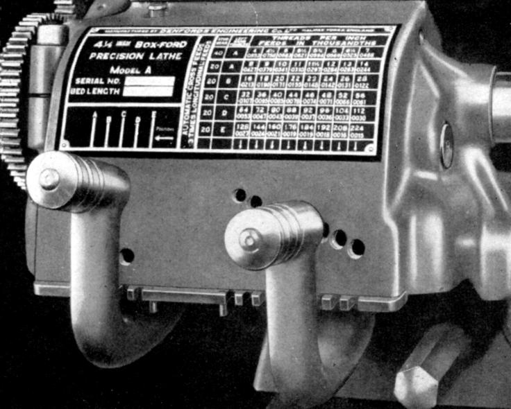

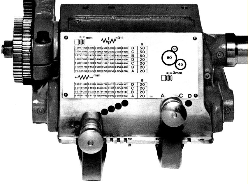

Boxford and the original South Bend "9-inch" screwcutting gearboxes were mechanically identical. The picture above shows a late-type Boxford unit for metric screwcutting--note, in contrast to the English screwcutting box illustrated below, the position of the levers is reversed laterally with the diagonal line of indexing holes moved to the left-hand side.
