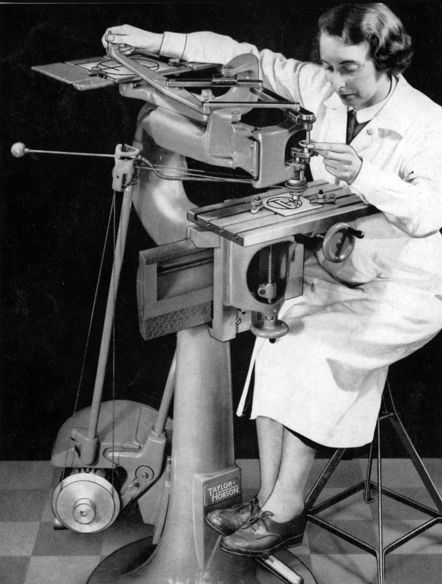

The first pantograph engravers manufactures were obviously the result of Herbert Taylor's fertile imagination and energetic drive, and would almost certainly have been developed to engrave lens mounts and similar items. The sheer usefulness of the engraver was immediately apparent and soon - at the expense of those involved in the hand engraving trade - orders were coming in from all manner of industries, the new machine able to engrave almost anything that could be cut whether flat, circular or irregular in shape. Eventually, by using an electric etching head, sold for many decades as the "
