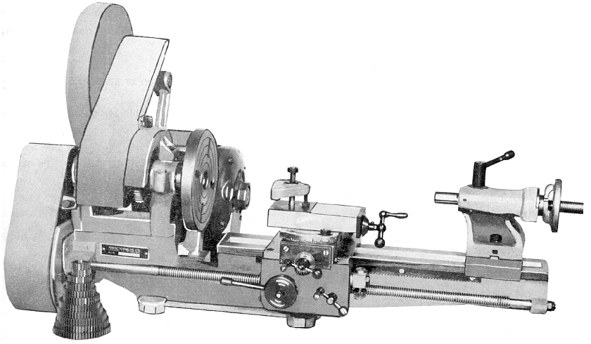

Late-model Perfecto from 1978 with taper roller bearing
headstock and full guarding of changewheels and belt runs
