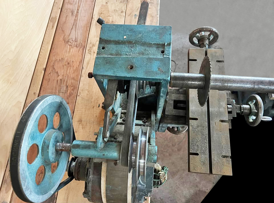

Horizontal spindle with its round-bar support overarm
Countershaft system used to drive the horizontal spindle
Horizontal drive system

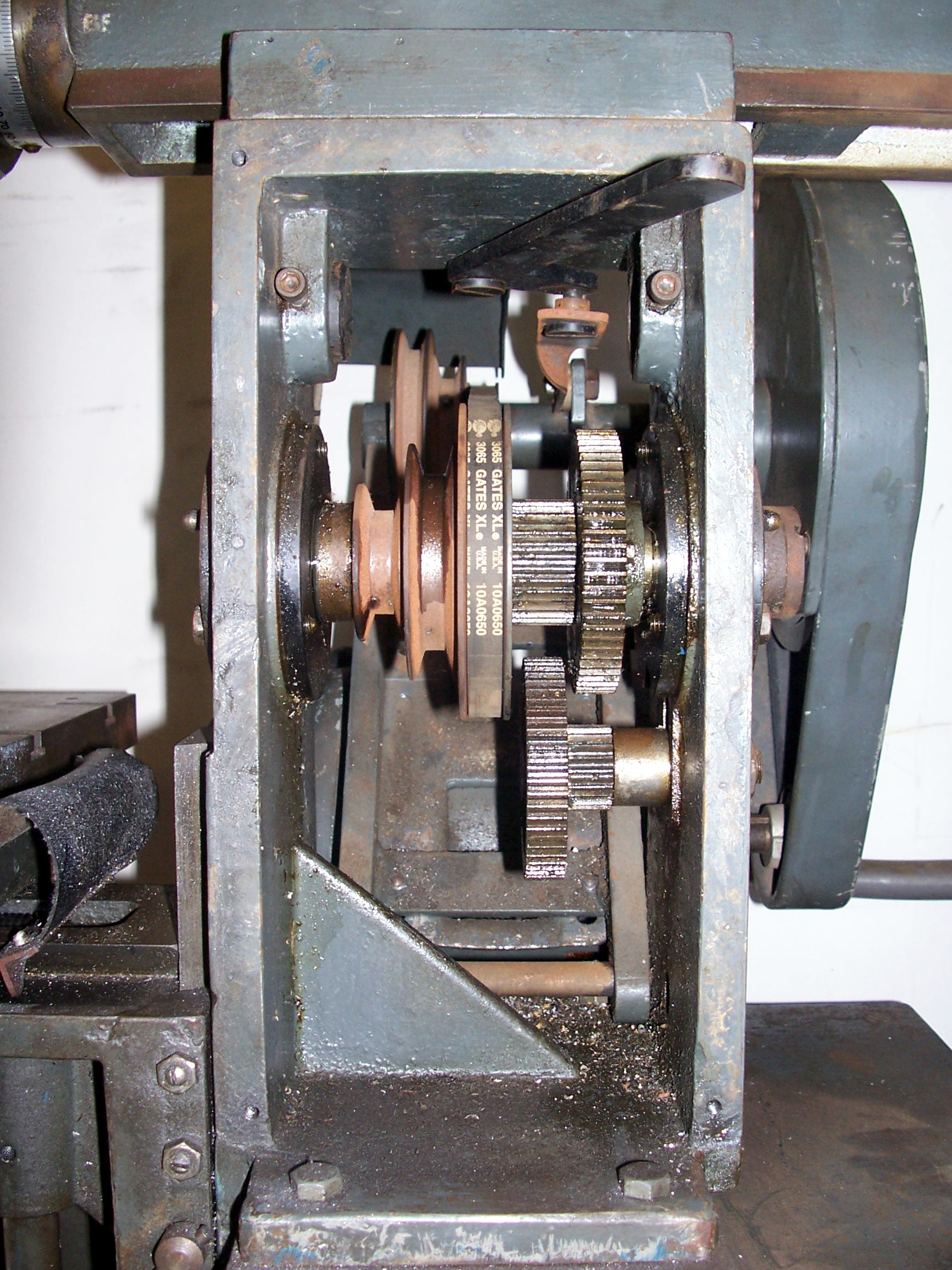

The low-speed,  lathe-like backgear mechanism fitted to the horizontal spindle - it appears to be identical to that used on the Perfecto lathe

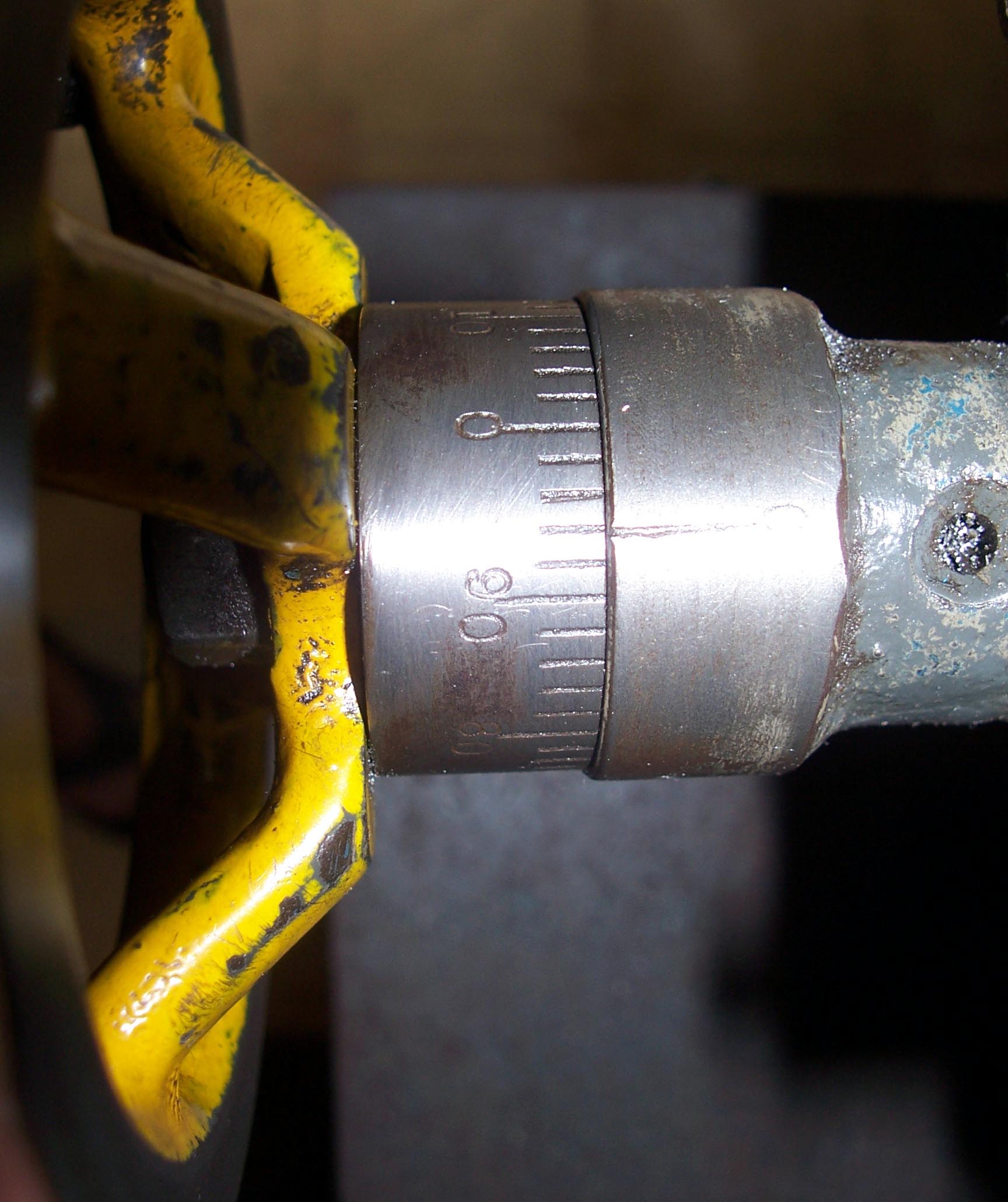

Longitudinal feed-screw handwheel and micrometer dial

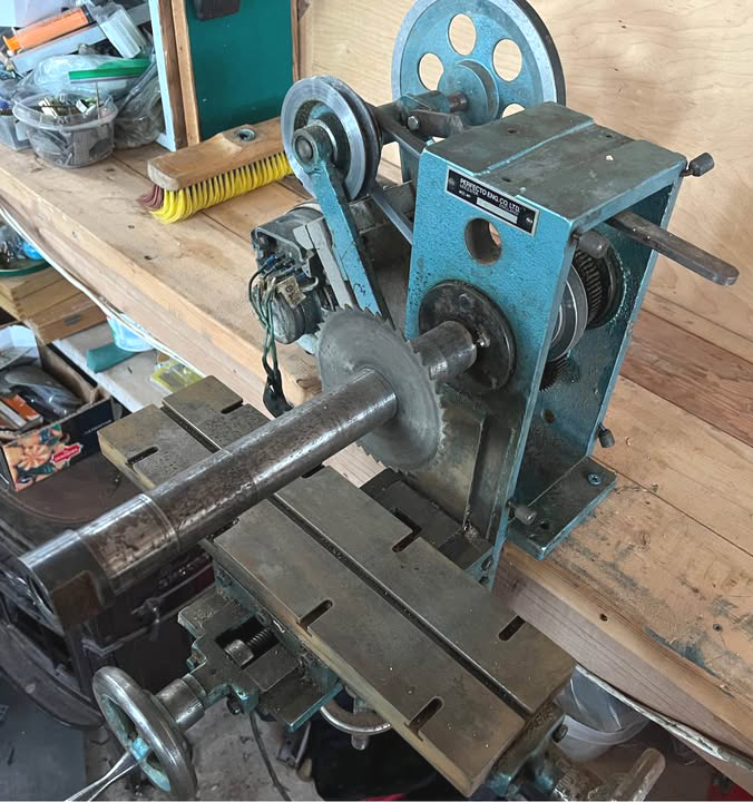

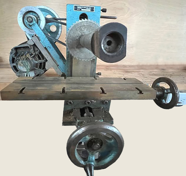

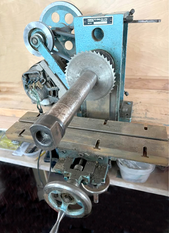

The very rare Perfecto horizontal milling machine
