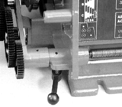

For each setting of the plastic changewheels, three auto-feed speeds were available, selected by a lever beneath the end-guard cover. A very useful automatic disengage was fitted to the leadscrew drive - ideal if you wished to leave a long, gentle cut running under power whilst attending to some other job. A very useful fitting, supplied as standard , was a graduated handwheel on the leadscrew end.

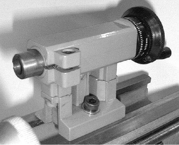

Fitted with a rather too-short, No. 1 Morse barrel (though very unusually for this class of machine, it was fitted with  a very large  micrometer dial) the tailstock could be set over for taper turning and had,

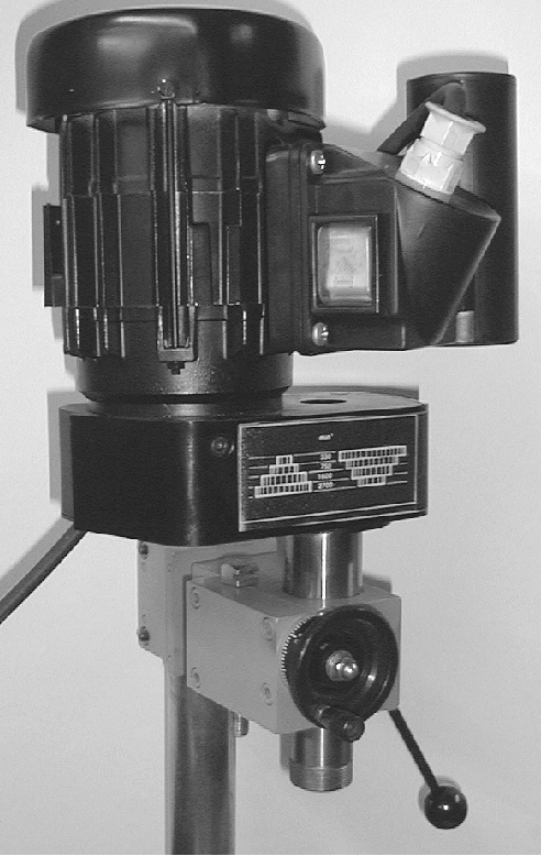

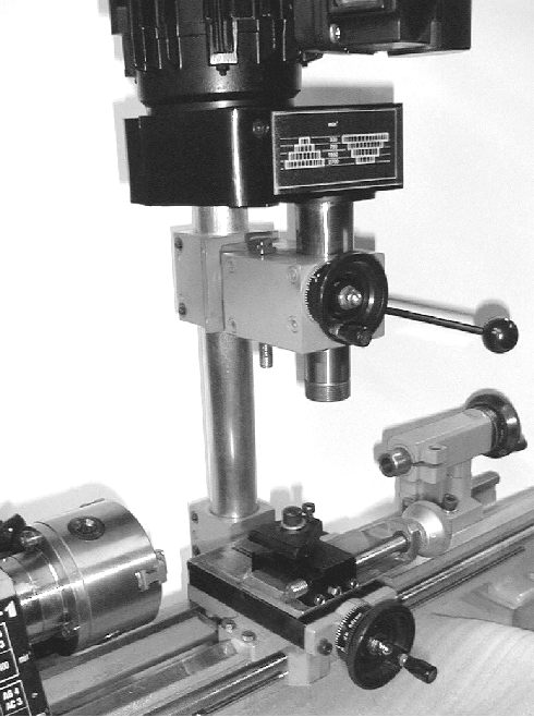

One very useful attachment was a neat, 4-speed (330, 750, 1600 and 2700 r.p.m) No. 1 Morse taper milling and drilling head with both fine and drilling feeds that bolted to the back of the bed - unfortunately, the controls for moving the quill were relatively crude, and lacked feel. A T-slotted table and vice were available to replace the cross slide when using the milling head.

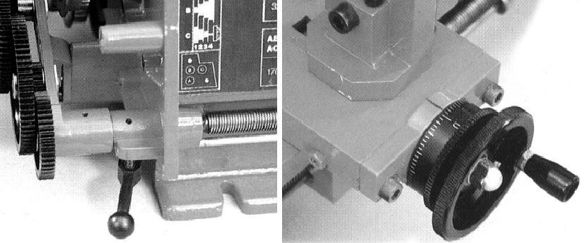

                         Lever to engage the leadscrew drive                                          Although plastic, at least the cross-feed dial was large and clearly engraved
Set-over Tailstock with large micrometer dial
