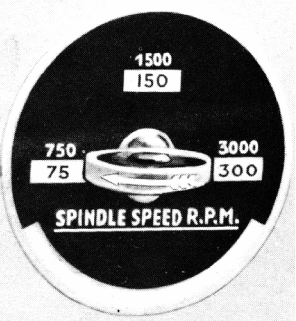

With its infinitely variable-speed drive and 3000 r.p.m top speed it was intended as a small but versatile high-speed precision lathe and was to form the basis of the later, cheaper and conventionally-driven Bantam. Being relatively complex, the Chipmaster was always an expensive machine - in some years it cost over 46% more than a similarly-specified but larger "Student" model for example - and in 1959 Colchester announced a short-lived, lower-cost alternative version, the "Six-Speed Model" stripped of the variator and with its spindle driven directly from a 3-speed motor rated at 5 h.p., 2.5 h.p. and 1.5 h.p. to gave spindle speeds of: 75, 150, 300, 750, 1500 and 3000 rpm. The lathe was fitted with a distinctive carriage-handle-shaped control (connected to a Stanton electrical switch) in place of the rotating dial of the variable-speed type. The design, construction and detail finishing on a Chipmaster was of an exemplary standard - as it had to be with a top speed of 3000 rpm - and was heavily built, the approximate weight of a standard machine being some 1204 lbs (545 kg), only very slightly less than a Student. The bed, hardened to order only at first but later fitted as standard, was particularly stiff, with chip clearance through elliptical holes that passed to the rear. On its introduction the Chipmaster was fitted with a two-speed motor, but this was quickly dropped in favour of a single-speed version with the speed range set, in both cases, to be virtually identical. At least two generations of this early variable-speed model were made: the first had its 3 h.p. electric motor (though often 1.5 h.p. on those sold to training establishments) and a comparatively small Kopp swash-plate variator constructed as one integral unit with a tall aluminium casting bolted to its side to support the shaft coming from the speed-change handwheel. From the variator the drive passed, using twin V-belts, to a first design multi-plate clutch (thought to be from Colchester's drawing boards) mounted on the headstock input shaft (immediately behind the main spindle) and from there to the headstock spindle by three V-belts on early machines and a toothed belt on all others - the latter element of design then surviving unchanged for the rest of the lathe's production life. These early models are rare, and problems with the drive system, probably concerned with its reliability, must have forced a rethink. On second-generation versions the motor was mounted facing inwards and positioned underneath the plate holding the variator. The latter was now larger, obviously more durable and driven from the motor by a toothed belt with a change to the proven matrix multi-plate clutch. The next stage in the model's evolution was to improve the manner in which variator and motor were mounted: originally, just a simple flat steel plate had been used, supported on three height-adjustable thick-walled steel tubes; the simplicity and comparative lightness of that design suggests that vibration may have been a problem for its replacement was a large and very rigid U-shaped cast-iron housing mounted on anti-vibration pads. Final drive on all models was through a virtually-indestructible Matrix clutch (although on later machines the unit was increased in size) that allowed the motor and variator to continue running with the spindle stopped. On the first two models the cast-aluminium speed-selector dial had an extra plate, positioned above it, indicating that the readings should be halved when running in slow speed. Electrical control was by a handle protruding from the top of the headstock (if wired correctly moving it to the right from the central "off" position caused the spindle to run forwards, moving it left reversed engaged reverse). This lever was, when new, fitted with a transparent plastic ball that glowed red when the machine was running. The clutch was controlled by single lever on the front face of the headstock: moving the lever to the right operated the clutch while pressure to the left engaged a spindle brake. On early machines the clutch lever had no safety catch and accidentally catching it could engage the drive; later models were fitted with an improved, spring-loaded lever that required the operator to first pull the lever outwards before it could be moved sideways.

Very rare Chipmaster with six fixed spindle speeds

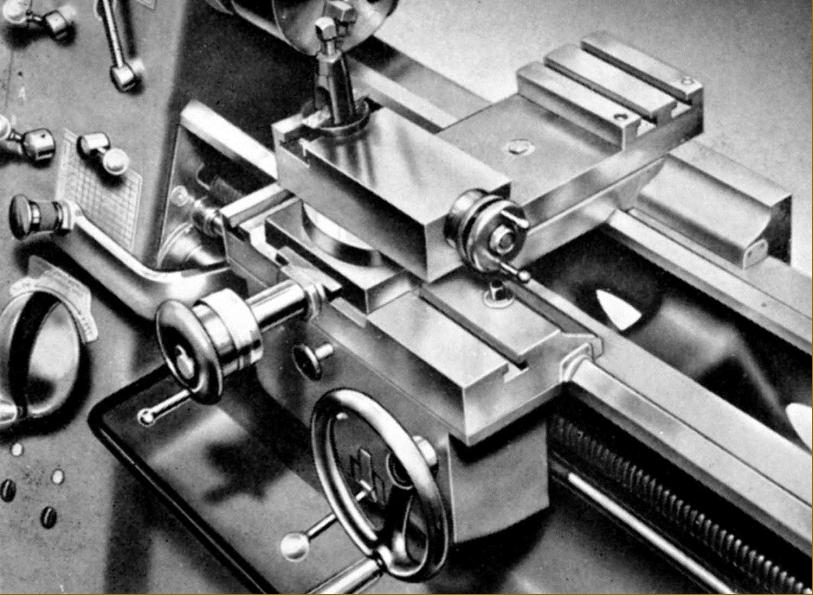

Early Chipmaster carriage
