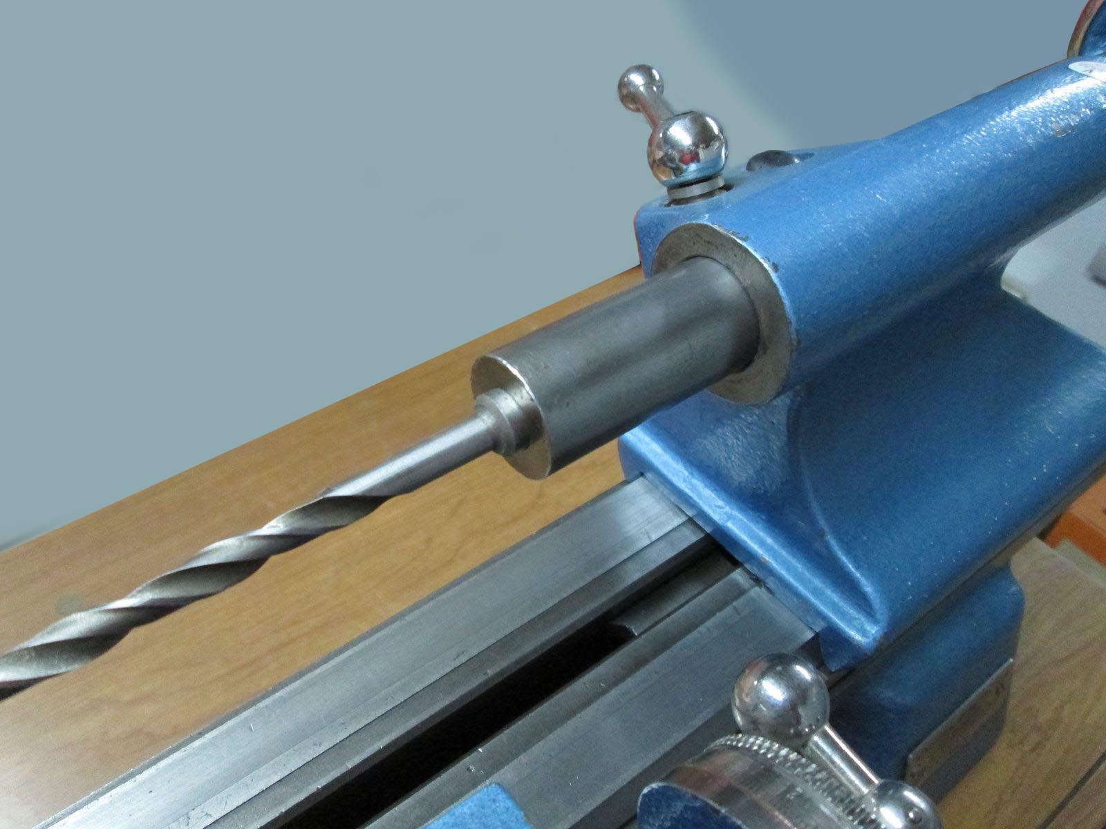

A recent find was an ARE labelled as the  Model TS-102S lathe, this being fitted with a heavy-duty lever-feed tailstock. The "S" might well be for "
seconde oeuvre" this translating as "Second Operation" - one of the three arrangements possible with this type of lathe, these being "Toolmaker", "Second Operation" and "Production".
Avez-vous un tour de ARE? Si c'est le cas, l'auteur serait heureux de vous entendre..
An ARE lathe Model TS-102 lathe with a lever-feed tailstock. The "S" might well be for "seconde oeuvre" this translating as "Second Operation" - one of the three arrangements possible with this type of lathe, these being "Toolmaker", "Second Operation" and "Production".
