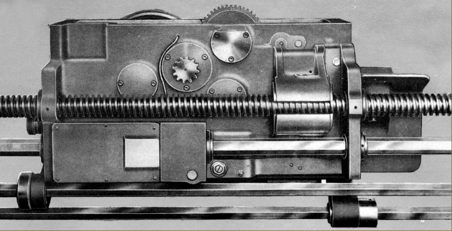

 Continued: Of massive, one-piece construction and doubled walled, the apron was equipped throughout with ball and roller bearings and pressure lubrication - a network of pipes directing oil to the vital points - and a built-in thread-dial indicator. As on some of the smaller Purcell lathes an instant drop-in-and-out worm box was used to start and stop the feeds - though with the additional refinement of a control to vary the point at which an automatic overload release tripped the drive - as well as a control lever to instantly reverse the feed without needing to stop the drive first. Not used on early versions, but fitted as standard later on, a rapid traverse mechanism powered by a 1 h.p. motor was fitted to the carriage drive - giving rapid repositioning either up or down the bed or across. Continued below:
