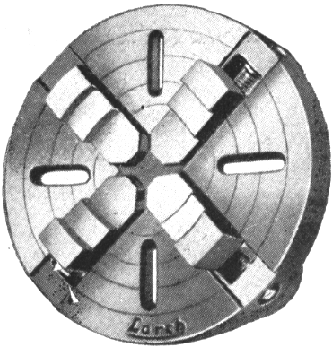

Accessory No. 20 the Universal 4-jaw Independent Chuck with hardened, reversible steel jaws. With the jaws removed it could also be used as a faceplate.

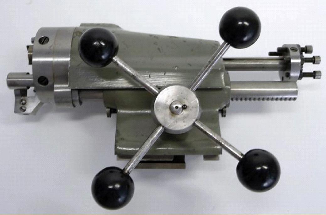

Part No. 24a - a 6-station, self-indexing Capstan Head and cross slide unit.
