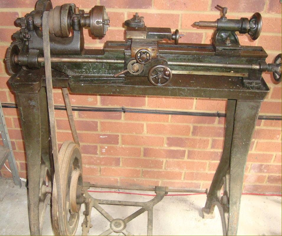

A "Super" Zyto complete on its original treadle and flywheel stand
