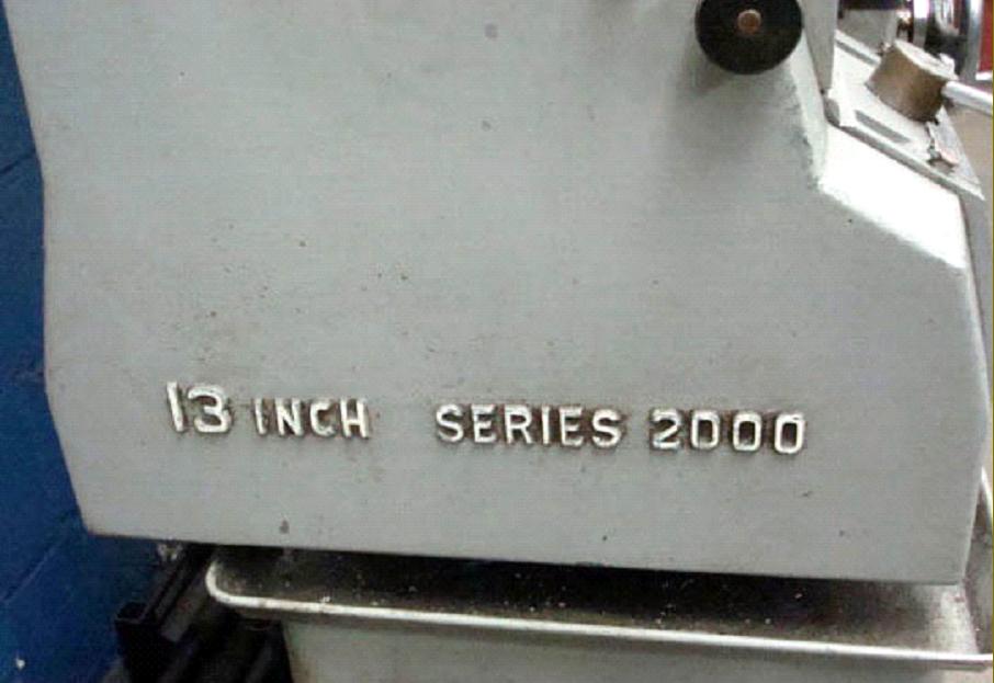

Unlike many machine-tool makers who seem shy of marking their models with Type Designations, Standard Modern usually made it absolutely plain which was which
