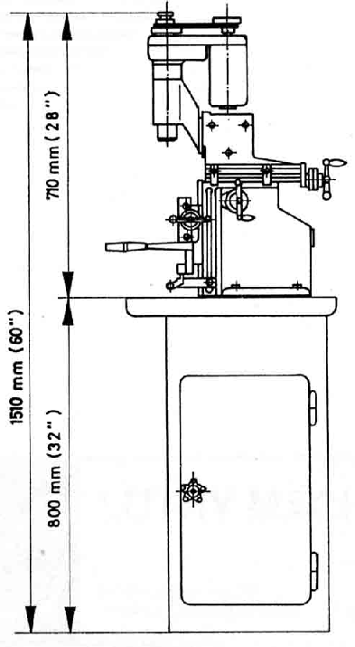

Designed for the precision machining of small components used in the instrument, watch, jewellery and similar industries, the Sixis 101 was a superbly made miniature universal miller capable, in the right hands, of the finest quality work. Like the better known and very similar (but rather lighter and smaller) Aciera F1 it is not as big as photograph might suggest and, even allowing for the full extent of the table's travel and the length of the operating handles, it is possible to mount and work one within a space equal to a square with a side length of little more than 24 inches (580 mm). With its cast-iron base plate the (58 kg/127 lbs) machine could be either bench mounted or fitted to the maker's heavy 60 kg (130 lbs) cabinet stand that was neatly arranged inside to hold a range of accessories.

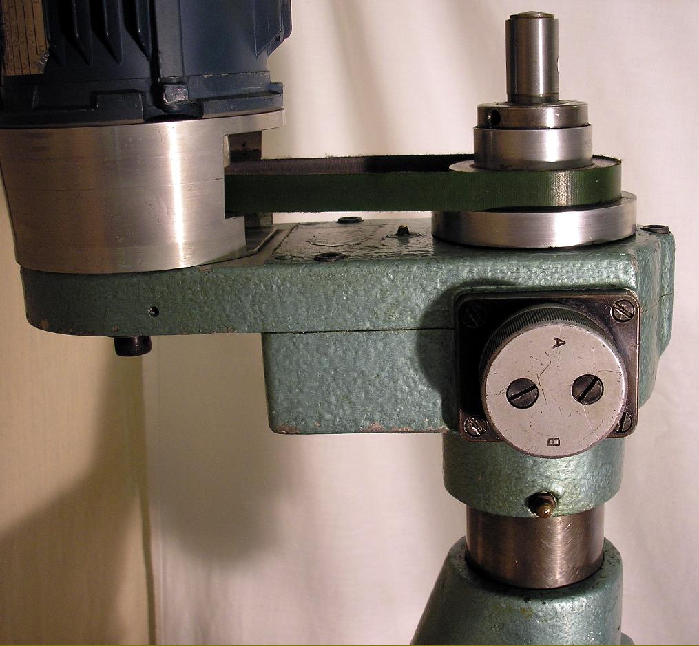

Consisting of a motor, a smooth-running 3-step flat pulley and a 2-speed gearbox, the drive system was arranged as a neat, integral unit and able to power the spindle in either a horizontally or vertical position (although in the latter case a support casting  part number 211 was necessary) with a total of six speeds that spanned 125 to 4000 rpm. However, these speeds were not fixed, the factory being able to vary the speed range according to a customer's requirements by fitting different pulleys - although the gearbox speed range always remained unchanged. The options available were:
Geared speeds: 125, 250, 500, 1000, 2000 and 4000 rpm
Direct (belt) drive: 1000, 2000 and 4000 rpm
2000, 4000 and 6000 rpm
6000, 8000 and 10000 rpm
9000, 12000 and 15000 rpm

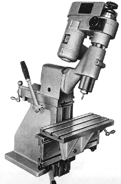

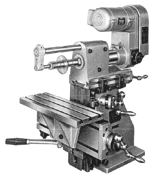

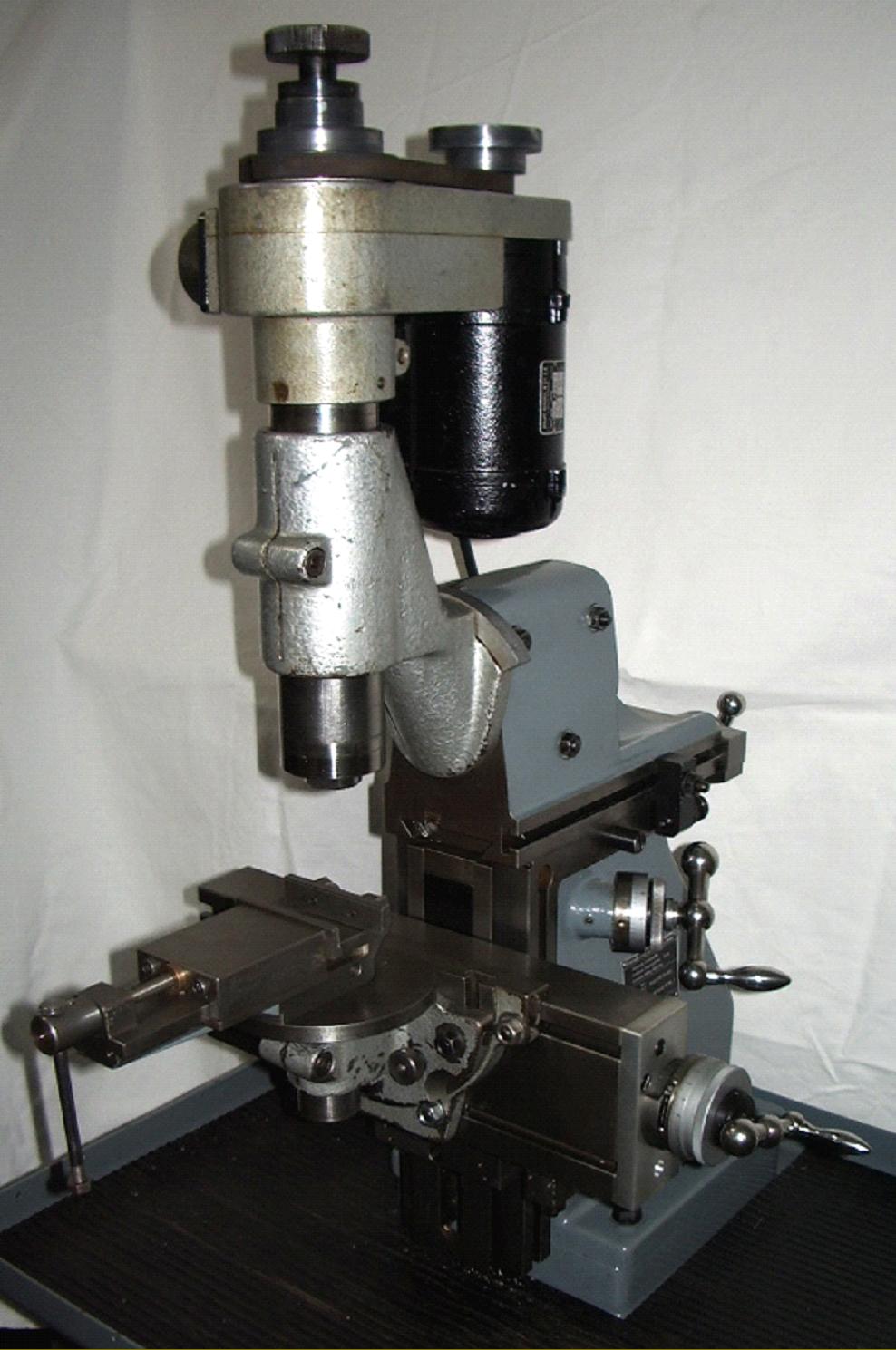

Sixis 101 shown, left,  as a vertical miller with the motor-drive system held in the adapter unit No. 211. A plain table was fitted as standard while the much more useful tilt-and-swivel version was an expensive optional-extra.  On the right is the Sixis set to work as a horizontal machine

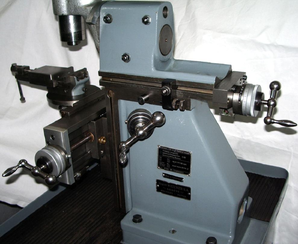

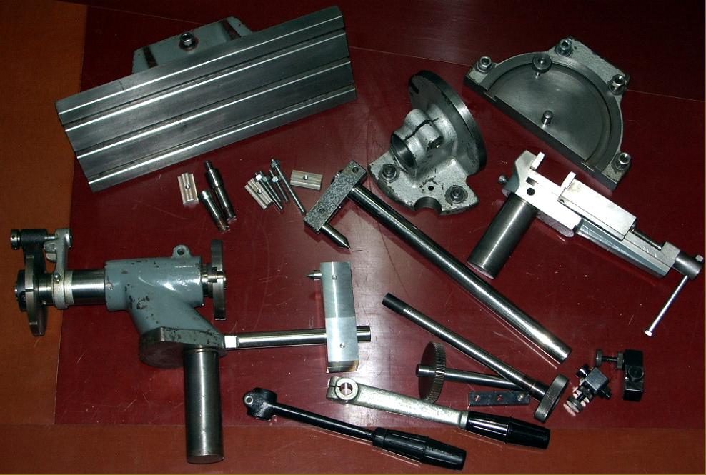

Sixis 101 fitted with a very rare indexing attachment. This unit was originally indexed by an external gear wheel but the owner has added a 40 : 1 worm-and-wheel gearing together with suitable degree and minute dials. The work took a not inconsiderable ten hours to complete.
Note the very large dial on the end of the dividing unit's rotating spindle
