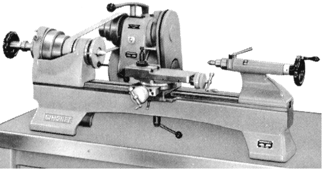

Besides the screwcutting  model, other versions of the lathe were offered: the DDA-102 was a semi-automatic second-operation machine, the DC-102 a plain-turning toolmaker's lathe and the DRA-102 an automatic capstan. Finally, a most unusual Simonet lathe, with a number of unique features
and believed to be a prototype - was discovered in an old storage building at Basel (Switzerland).

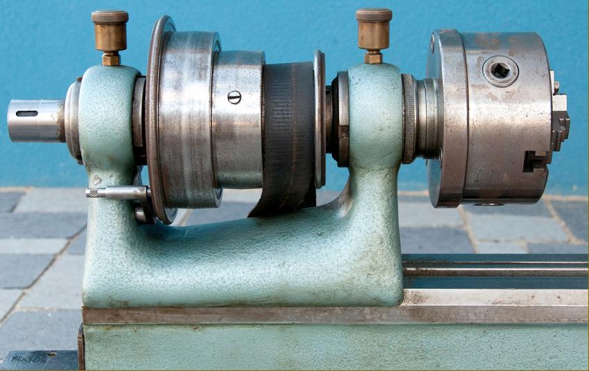

Backgeared headstock No. 518 with quick-release, lever-operated collet closer and changewheel drive - via a tumble reverse mechanism - to the screwcutting leadscrew. On top of the left-hand headstock bearing can be seen the eccentrically mounted plunger which engaged two (or three) rings of indexing holes formed in the end flange of the headstock pulley.
Headstock No. 214 with 5 ; 1 ratio backgear and standard draw-in collet

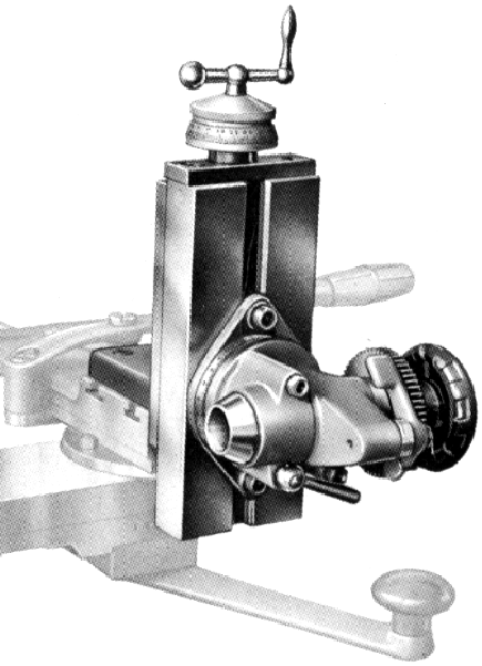

Vertical Slide (No. 250) fitted with the Milling Head (No. 245).
The head could be driven at speeds up to 3000 rpm and took W12 collets.

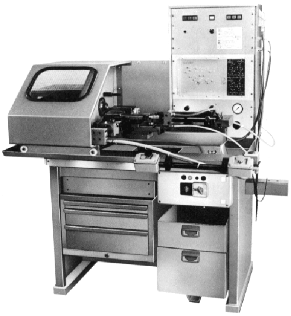

Simonet DRA-102 Automatic Capstan Lathe.
Simonet DRD-102 Semi-automatic Capstan Lathe.

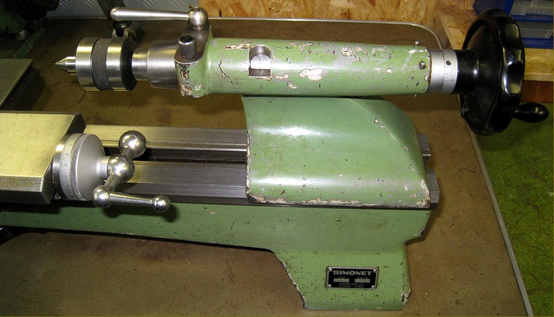

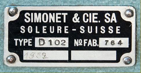

Simonet Type D102 plain-turning lathe
Another example of the Simonet Type D102 plain-turning lathe
