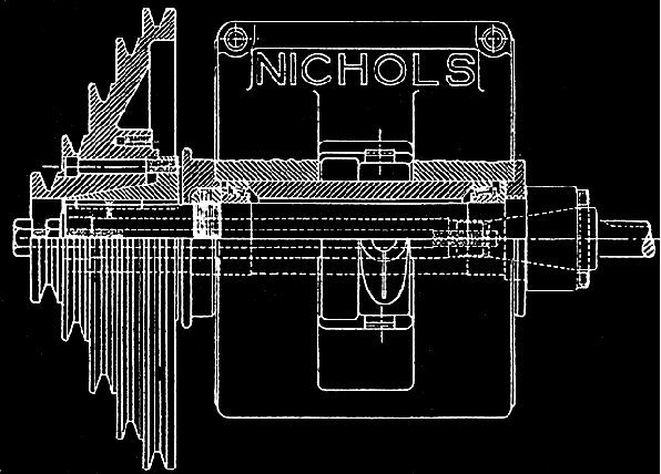

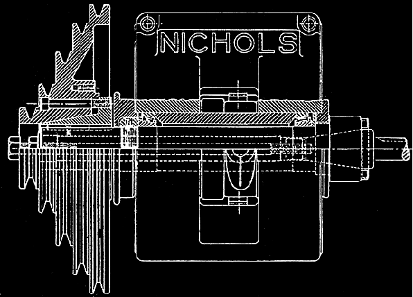

Section through the main spindle and overhung cast-iron drive pulley

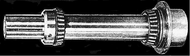

Ruggedly built, the main spindle had a 1-inch bore, a hardened and ground nose and a 40 MMS taper. The standard models ran on taper-roller bearings while the high-speed version, which could attain 5000 rpm, used pre-loaded ball races.
The spindle nose was provided with four holes tapped 5/16" x 18 t.p.i. Cap screws were fitted to diametrically opposed holes to act  as driving lugs for arbors whilst a notch was also cut in the mouth of the spindle to act as a means of positively driving collets or other fittings. A radial hole was also provided to carry a pin that engaged with the bayonet locks on short, quickly-interchangeable boring bars - these allowing the operator  to rough out and finish at one setting.

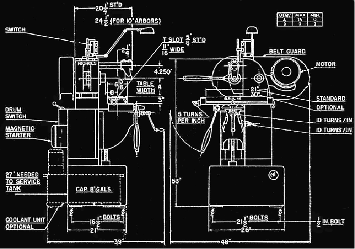

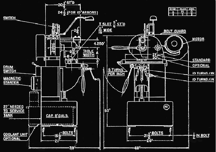

The table was fitted, as standard, with two micrometer stops
