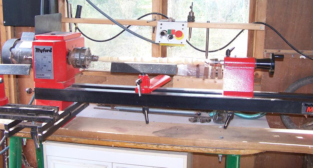

Typical Mystro set-up with the lathe mounted on a purpose-built steel-framed
stand with wooden top. This lathe has the later and stronger "solid-top" T-rest support
