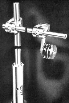

Powered accessories, no matter how awkwardly aligned they are with the lathe bed, can be driven by looping their drive rope around the adjustable Idler Pulley Attachment.
![](img18.gif) |
Alternative forms of Idler Pulley Attachment: Left - the Auxiliary Motor and Swivelling Idler (Code ACAE) designed to make the driving of powered accessories independent of the lathe motor. Below - the Idler Pulley Stand (Code ISPP) mounted to the bench top by a single screw. The height and cross-arms' settings can be altered to bring the drive belt to any desired position

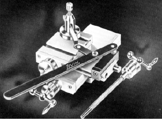

Heavy Duty Compound Slide Rest Code ABLW with screw feed to both cross and top slides Levin slide rests have been available in many different styles and with multiple combinations of features - and besides being interchangeable across the Levin range are easily adaptable to fit other makes of miniature precision lathe. Made from Meehanite iron, the rests are can be found in both Standard and Heavy-duty (covered top slide) versions with either two screw feeds, two lever feeds or any combination of lever and screw feed on the top and bottom units - special "Triple-compound" units have also been produced, as well as double-tool slides specifically designed to improve the functionality of the Turret lathes. The ground-finish feed screws are fitted with ball thrust bearings and zeroing micrometer dials having a non-glare finish. The hardened stops on both slides consist of a long bar, which slides in the casting, for coarse settings and a locking micrometer screw protruding through the face of the end flange for fine adjustment. With its degree graduations on a bevel surface for easy reading, the swivelling top slide is clamped by two T bolts and carries a toolpost which can be height adjusted. The circular base of the toolpost extends over the T slot and provides a large area against which the thrust of the T bolt is taken, so eliminating any chance of the slot being "broken out". Both lever and screw feed slides can be converted very easily from one type to the other by bolting on the appropriate parts - it is not necessary to buy a complete, new slide. Levin accessories continued here

Heavy-Duty Compound Slide Rest Code ABLX with lever feed to both cross and top slides. Any combination of screw or lever feed could be supplied to order. Slide rests here

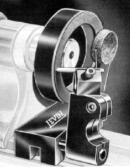

Graver Sharpening Set. A necessary part of successful hand-graver work (turning by holding the cutting tool in the hand) depends upon being able to keep the tool sharp. The Sharpening Set was available as a boxed kit, or as separate components, and designed to make this task as easy as possible. Levin Gravers, made from high-speed steel, 1/16" square and 2.5" long can be gripped in the special "pin chuck" and are useful for any kind of hand-turning work.
