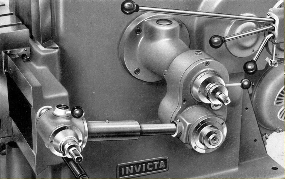

Six versions were offered originally, the - 1M, 2M, 4M, 5M, 6M and 8MR - all being of identical design and with ram strokes of, respectively, 10" (254 mm) 14" (355 mm), 18" (457 mm), 21" (533 mm), 24" ( 610 mm) and 30" (762 mm). At some point in what must have been the late 1940s, the 8MR disappeared from the catalogues - replaced, presumably, by the rather heavier "Major" 30" With the exception of the little 1M, running alongside the standard "M" versions, with their simple 4-speed ratchet-fed cross feed mechanism, was the MR range - these being fitted with a more complex but easily-handled 6-speed table-feed gearbox with one lever to selected the required feed rate and another the direction of travel. To help speed production an instantaneous reverse mechanism was also  fitted and feed rates could be changed without stopping the drive.

Standard M-Series ratchet-type  table-feed mechanism
MR-Series table-feed mechanism through a speed-change gearbox
