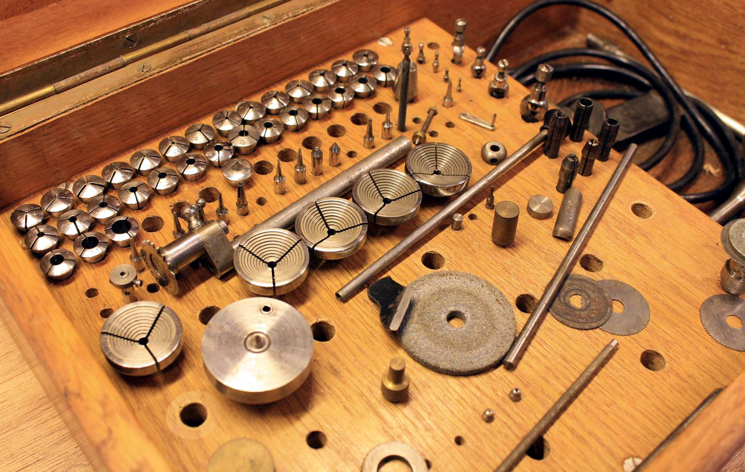

Manufactured in Holland by a Company better known for its electrical products, the Hazemeyer Company appear to have manufactured - from around 1945 to 1950 -  just two lathes for watchmakers, a heavy, 50 mm centre height by 200 mm between centres watchmakers' WW type and a lighter Geneva-pattern model.  lathe was current from around 1945 to 1950. Heavily constructed from cast iron and steel - and very well finished - the Model HH was built along conventional WW lines (Webster Whitcomb) with an unusually massive, flat-topped, bevelled-edge bed. The screw-feed compound slide rest fitted was equipped with much larger micrometer dials than normally found on this class of machine, these being in bronze (or possibly brass) and able to be zeroed. Supplied in a fitted wooden box, the lathe took 8 mm collets in its headstock spindle and was delivered complete with a good set of essential accessories including wire collets, four stepped collets, collets for the tailstock, wax chucks, arbors (chucks) to take grinding wheels and slitting saws, etc., a flip-up hand toolrest , drive dogs,  a set of tailstock runners and a self-centring drilling attachment. Complete, boxed Hazemeyer lathes appear to be rare, most now being discovered bereft of all but the basic accessories.
