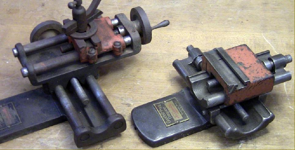

On the left and earlier version of the Goodell-Pratt slide rest and, on the right, its more rigid replacement
![](img7.gif) |
With its unusual "curved-edge" ways, the later compound Slide Rest assembly (Part 132), had a longitudinal travel of 3.75" and a cross of 2.25", was described by the makers (in their usual honest style) as a strong and thorough well-made device although not a precision tool. Because the top slide did not swivel on its base, the assembly could not be described as "compound". A long T-slot was provided for the tool holder, which accepted 1/4" x 1/4 bits. At $17, even though no micrometer dials were provided for the feed screws, it was a comparative bargain, the Precision Compound Slide offered for the smaller 700 lathe being more expensive at $85.

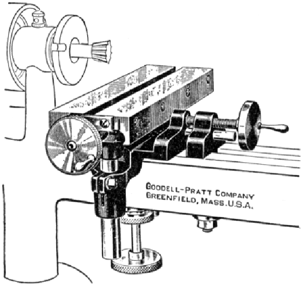

Plan view of the compound slide rest
