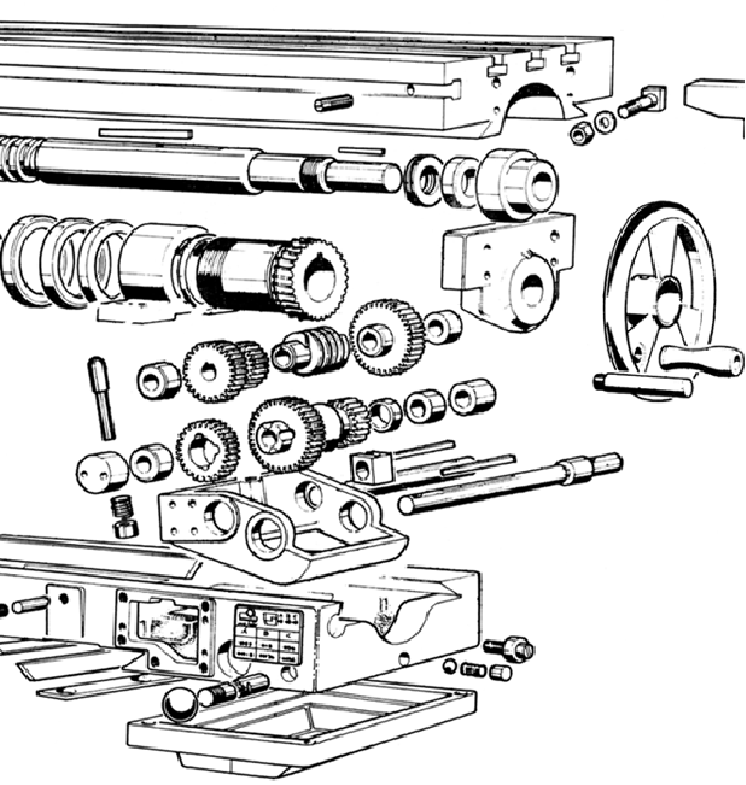

The "Junior" Omnimill had a 28" x 7" table (Juniormill 28" x 7") with power feed by means of a belt-drive take off from the top horizontal spindle pulley through a telescopic shaft to a 3-speed feed box built into the saddle. The drive could be engaged and disengaged through a "drop-worm" that connected the drive to the table's feedscrew - with  selection by a simple push-pull lever.
With three 7/16" T slots, and moved through 18" longitudinally and 6.25" in traverse, the table was arranged with coolant drain sumps at both ends - but with the T slots running right through them so usefully extending its working area. As an unforgivable economy, the makers supplied only one handwheel, normally fitted at the right-hand end of the feed screw; however, the operator could, if he desired, change it over to the other side. Later machines were fitted with a self-contained, electrically-driven table-feed unit as standard - although it is possible that some customers may have specified machines for delivery without. The table motor drove first through a pair of spur-type reduction gears, then through a series of operator-changed pick-off gears that were neatly (if inconveniently) stored in pockets in the rear cast-aluminium (later fibre-glass) belt cover. The final drive was through a worm-gear reduction that bore directly against the table's feed screw. Eight different rates of feed (from 1 to 9 inches per minute) were available and, because the drive was independent of the spindle, any could be selected in combination with each spindle speed. An automatic, adjustable trip-out was fitted to the table that disengaged it in both directions of travel. The modified drive allowed later machines to have a traverse travel of 7.5", though the longitudinal travel (and vertical travel of 12") both remained unchanged. Marked in 0.002" (0.04 mm) divisions the zeroing micrometer dial on the longitudinal feed differed from the others - their graduations being at 0.001" (0.02 mm) intervals.

Table-feed details for the Junior Omnimil
