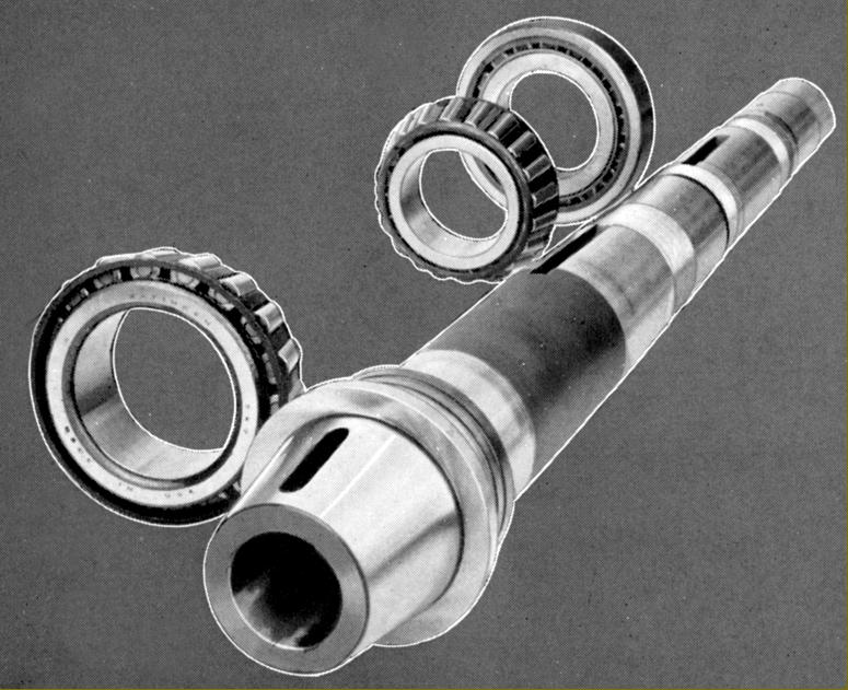

Lubricated by splash from an oil sump, the all-geared headstock held flame-hardened gears and a spindle running in two Timken taper roller bearings on the 10 and 12.5-inch models but three on the larger types - the additional bearing being placed centrally to improve rigidity. The spindle nose, instead of being threaded, used the recently introduced
American Long-nose Taper in an L00 size on the two smaller versions and an L0 on the larger - the arrangement providing a stiff mount, complete safety when run in reverse and reasonably quick mounting and dismounting of fittings.

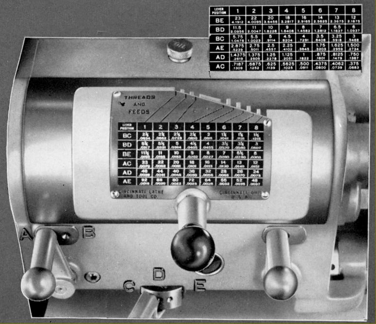

Screwcutting was by an oil-bath lubricated, totally enclosed quick-change gearbox (so preventing the ingress of swarf, dirt and malicious objects) with both inch and metric pitches available, though the latter did require the mounting of two additional gears and the repositioning of three parts ….). Instead of the leadscrew reverse being built, conventionally, into the changewheel drive, on the Tray Top it was incorporated into the screwcutting gearbox. Each lathe not only had a leadscrew sized correctly in diameter and pitch  for its capacity (1" by 8 t.p.i. on the 10-inch; 1.125" by 8 t.p.i. on the 12.5-inch; 1.25" by 6 t.p.i. on the 15-inch and 1.375" by 8 t.p.i. on the 18-inch) but also an appropriate range of pitches and sliding and surfacing feeds. The 10-inch and 12.5-inch shared a range of 48 threads from 3 to 184 t.p.i.  while the 15 and 18-inch versions had 48 pitches available from 1.5 to 92 t.p.i. Sliding feeds on all versions ranged from 0.0019 to 0.125" per turn of the spindle and cross-feed rates from 0.0005 to 0.0308" on the two smaller lathes and from 0.009 to 0.0578" on the larger.

Screwcutting and feeds gearbox with (top right) a metric screwcutting chart

L0 headstock spindle and bearings
Section through headstock spindle and bearings as fitted to the 3-bearings, 15 and 18-inch lathes
