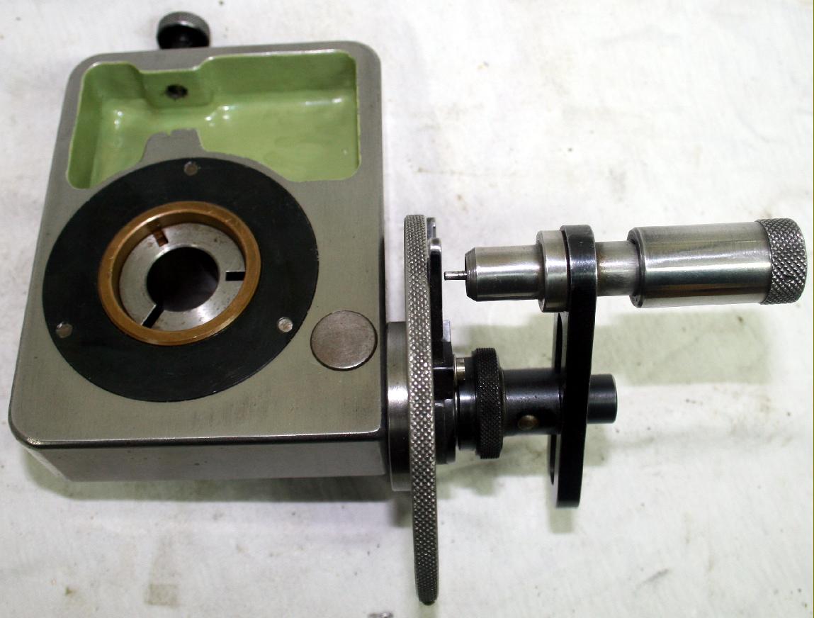

Above: Aciera F1 swivel support holding the "Simple Dividing Head". The same system held the universal table, complex dividing head and rotary table.
