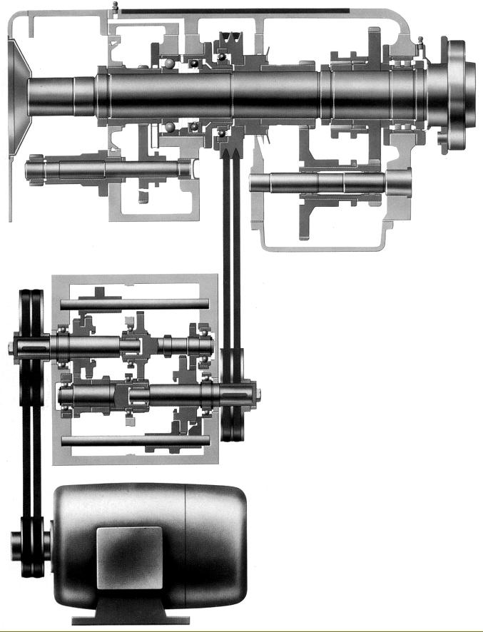

Complete transmission system of the Model VS showing the twin V-belt drive from motor to the 9-speed, car-like pre-selector gearbox then by another double V-belt to a pulley on the headstock spindle that ran in its own bearings. In conjunction with 1 : 5.7 ratio backgear this arrangement gave 18 spindle speeds of 24, 34, 50, 80, 115, 135, 165, 190, 235, 285, 335, 440, 500, 630, 930, 1330, 1900, and 2800 r.p.m. Alternatively, special speed ranges could be ordered which, by using a two-speed 3.0/4.0 hp motor, extended the range downwards to as low as 12 r.p.m. whilst leaving the usefully-high top speed unchanged.
