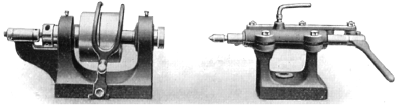

Taylor "Model A8" separate headstock and tailstock assembly for use by the customer in their own installations. The headstock spindle was threaded internally (3/4-inch Whitworth) hardened and ground and ran in conical gunmetal bearings. The tailstock could be supplied with either a lever or screw-feed barrel.
